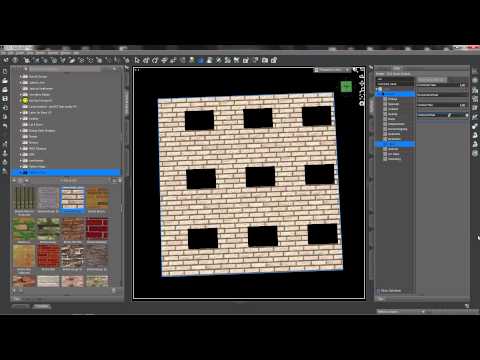

Found a great short tutorial for the Tile Shader by Jabba as well here:
Thanks for the help!
