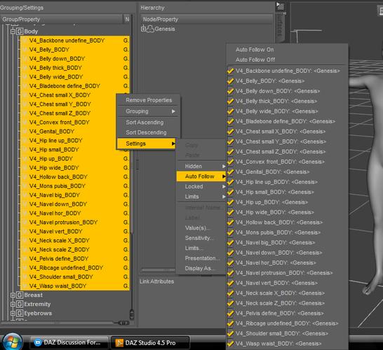

    mjc1016 said:
    I did them by hand, because I ended up doing 9 of them in a row, instead of editing then using the Property Editor. You do know that you can batch edit with the PE (see pic), Shift+Left click to select a pile of them or Ctrl+Left click to be selective.

    Bejaymac said:
    Also, there are those who don't like/use Hexagon (and I'm one who finds Hex as 'annoying' as many find Blender), so until there is a Blender bridge all the bridges are pretty much worthless (don't have and aren't going to be shelling out $700 for Zbrush either...).
    Has that plugin been updated yet or is it still creating DSF files to the early DS4.0 standard (JSON rather than DSON), if it has been updated has he added the presentation and the modifier type to it's functions.
    Dang it...take all my steam away...I had forgotten completely about batch mode. But I still say a check box would be nice (easier...).
