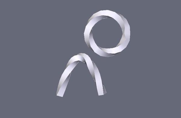

Hello,
I modeled the object in the attached picture. As you can see, there are some jaggies along the curved edges.
What I did is:
1-create a cube with tess 48
2-Create a an arc with 256 points
3-Bend the cube along the arc
4- Use smoothing level 1
I end up with 127898 tris but still a lot of jaggies.
How could I do this so that I get smooth curves everywhere?
Thanks!
892 x 1438 - 133K

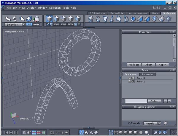

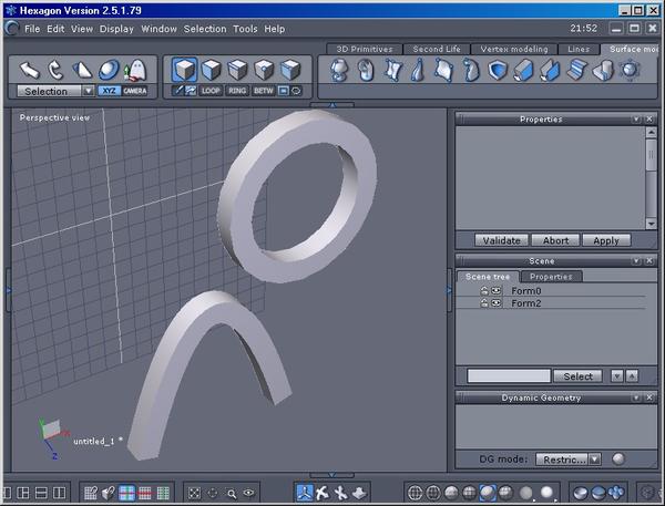

No matter...there's an easier way that will give you better results with more control: Use the "sweep line" tool.
Create the arc you want adjusting the number of points in the line to whatever pleases you. Your example uses 256 which is quite dense.
Also using a line, create the shape you want the arc's body to assume. In your case, starting with a cube I would assume you want a "square" cross-sectional shape. In this case instead of making a square with a line tool you can use the "square" or "rectangle" maker which is also found in the "Lines" tab.
Place the square at one end of the shape, select the "sweep line" tool under the "Surface Modeling" tab, and then click on your arc.
The square will sweep the line using as many segments as you created the line with (in your case, that would be 256 segments).

Looks like kzamor needs a bit of twist in the swept profile. How could you do that with sweep line ?
Actually I took the twisting as an unintended artifact from bending, even though it doesn't look at all unattractive.
However, if he does want the twist, the sweep control has a "taper" and a "twist" setting that can be played with.
Here's the same 2 objectx as obove with an arbitrary "400" as a twist factor. Leaves a bit to be desired for closed loops but you can get pretty complex with open lines such as arcs.

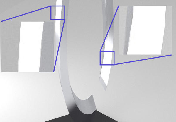

Yes, the twisting is part of the design like in afreaginname's post. But I really want smooth edges, just like if I sculpted it in wood and then sanded it down to a 1000 grit. I don't care if it takes boatloads of memory or takes ages to render, I just want it to look smooth!
Even at 263000 polys, it's still jagged at some places. I must be doing something wrong. Any ideas?

OH NOOOOO!!!!!
Is THIS what you're calling "jaggies"??? The ONLY way you'll get rid of them is to do a full rendering with antialiasing!
You have to understand the medium you're playing with here. Lines and curves are built up of discrete sections that are exactly one pixel wide and high on your screen. On a quick render like you have here, the pixel is lit if more than half of the calculated point overlays that pixel and not lit if less than half. An LCD screen (say) CAN NOT SHOW half a pixel on 2 adjacent pixels. Drawing a straight computer line top to bottom on a computer screen when the top pixel is one pixel to the right of the colomn that the bottom pixel is on results in a vertical line from the top pixel straight down to the middle of the screen, and then it jumps over one pixel and draws the rest of the line straight down to the bottom pixel. This gives you a "jag" in the center of the line.
Antialiasing fools the eye by adding shading to these pixels according to how much of the pixel would be covered if it were a true "line". The mathematical definition of a "line" is an infinite number of points lying between 2 endponts, but computer monitors don't have an infinite number of points.
Here's a thought experiment for you: Take a bunch of square pieces of paper. Lay 2 of them out as endpoints of a line. Now take others and connect them so that there's a continuous path of squares between the starting square and the ending square with the following restriction: The squares can only touch at corners or along full edges. They can't be overlaid in anyway.
This is how computer monitors draw lines on screens.
PS: Your image is monochrome, and this greatly exacerbates the "jaggie" effect. Adding colors to both object and background areas aids the antialiasing engine in creating the illusion of smoothness, and this is why your other samples look smoother than your original image.

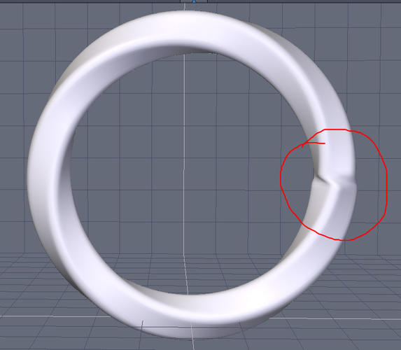

I tried this, but ended up with a weird bump in the circle. Could you tell me how you got rid of it?
Yeah, so did I:)
Got rid of it with a light brushing with the soften tool - under the UV & paint tab.
Hopefully some guru can explain to us how not to have that bump in the first place?
You need to adjust the twist rotation amount until the two end profiles align (currently they do not)

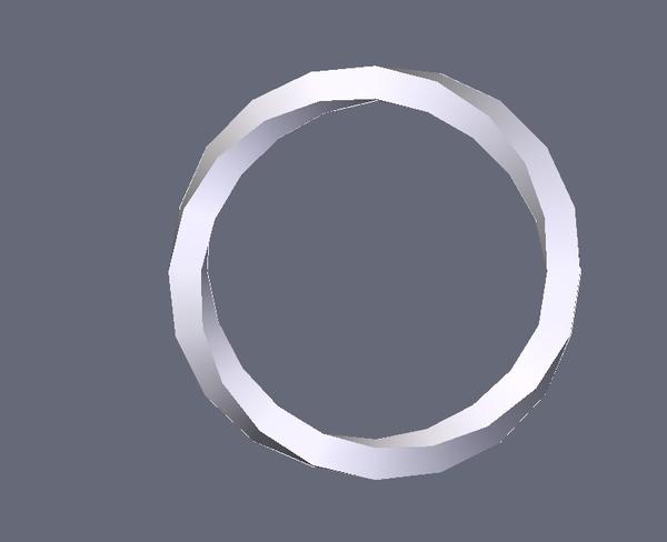

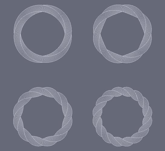

Here's a circle with a square cross section with 360 applied to the twist:
Oh wow!! This "twist" algorithm is BUGGY!!! I'd give my left arm to examine the code!

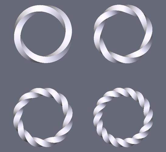

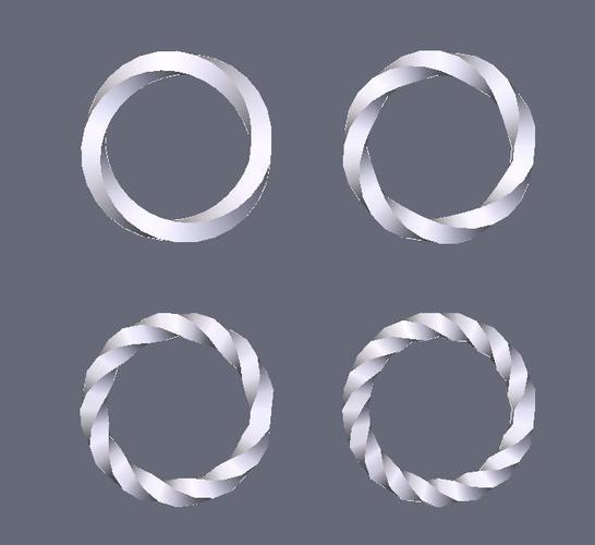

Here are 4 circles with square cross-sections, with twists of 360, 720, 1080 and 1440 applied (1,2,3 and 4 complete rotations of the square).
I now see that even 360 has a flaw, although possibly tolerable.
But beyond that, the flaw seems cumulative and even 720 is immediately intolerable.
Thanks - now that we know it refers to degrees, it makes sense. Possibly the reason that 1/4 and 1/2 doesn't work on a square is because the square is not precisely square?
Found that it does work well with 720 and 1080 if you harden the edges and smooth.

Here are the 256 pt circles with 358.5 | 717 | 1075.5 | 1434 degree twists
