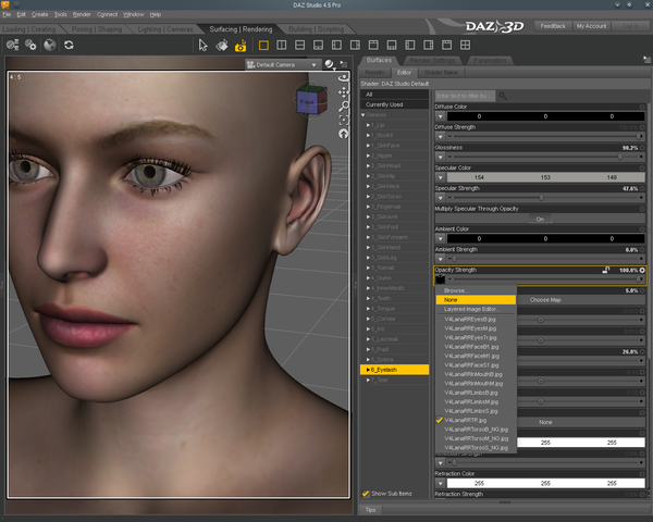

    hakatre said:
    Ok, that's great uh, now how does one remove the transparency maps? I brand new to this stuff.
    In the Surface pane look for Opacity, then set the map to None.
    1280 x 1024 - 516K
    Post edited by mjc1016 on
  • hakatrehakatre Posts: 0
    Ok, I see now that you meant "opacity strength." I'm familiar with the surface settings. Didn't solve the issue with the invisible hair. But, I'm happy for the moment.
