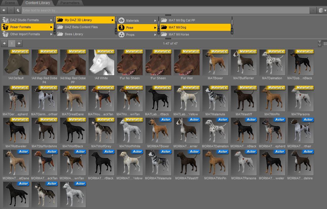

    The dogs are old (as the name indicates), which is why you will find the materials in the Poser Formats part of the library.

    The full version of the dog is located in "Content Library > Poser Formats > [content library name] > Figures > DAZ Animals"  The poses are in "Content Library > Poser Formats > [content library name] > Pose > DAZ's Mil Dog", and the materials and morphs in "Content Library > Poser Formats > [content library name] > Pose > MAT Mil Dog".  The files in "MAT Mil Dog" that begin with MAT are just the materials, and will work on both the full and LE versions of the dog; the ones that begin with MORMAT apply both the shape and the materials, and the shape part only works on the full version of the dog.  I'm not certain where they show up in Smart Content -- I think the DIM-installed version shows up in Default > Animals, and the Connect-installed version in Default > Figures > Animals.

  • Need to run, but I took a quick look. I only see one dog in the "DAZ Animals" ... is that one dog used for all breeds? Also, I found poses and materials, but I don't see content from the Canine Combo, only from the Starter Pack (for example, no Labradors, which I think were in the Combo). Anyway, thank you again SO much for the help & pointers!
  • I take it back. I see the Labs now. I guess my only remaining question is whether or not there's supposed to only be one dog in the DAZ animals, or a separate dog for each breed. Thanks again!
  • There's a single base figure, which is morphed to diffrent shapes and has different textures applied.
