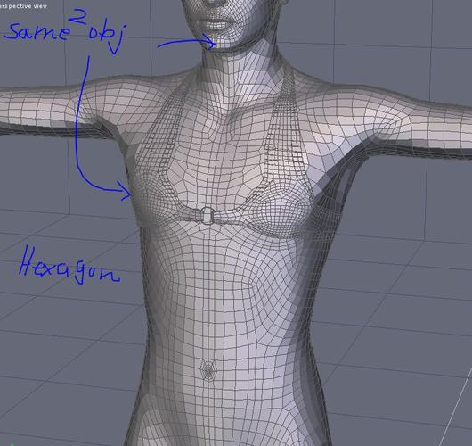

when I use hexagon,, if I do not use bridge, I can easily adjust setting to export obj as I want,,

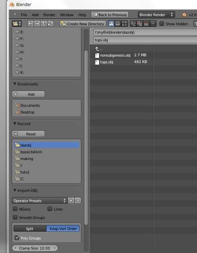

    yes,,,now I try again,, you are right, though, I did not change setting ,,(I try samethings almost 20 times ^^;
    if I missed or change export size,, but everytime,,, I import genesis and clothing , clothings or genesis,
    show up strange positon or scale ^^;)
    but ,,,,,,, clamp size zero work ! (picture1)
    I everytime export from ds as 100%size,, then change setting of other 3d tools when import obj,,
    and when I use clamp size zero, genesis become so big and grid far away,, I tried another scale
    eg cramp size 1.00 but genesis become too little,, like been,, so
    so may need to more than 10 th scale when improt to blender,, I thought,,,
    then I did not try cramp scale 0.00 never,, but it works ,,,
    (why,, zero,,,yes it seems defautl value,,, but ,,zero ^^;)

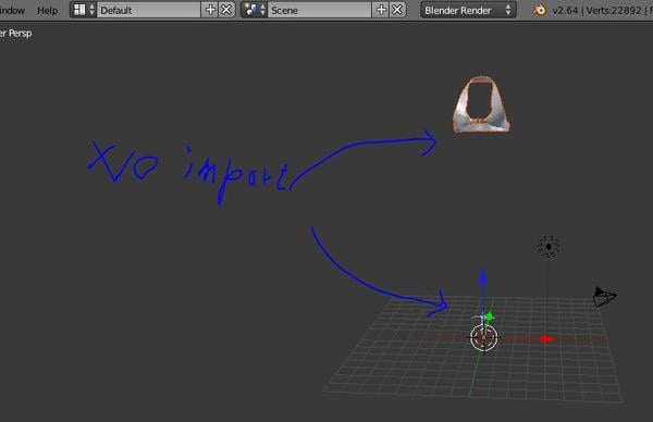

    and if I change clamp size eg scale 10 ,
    then improt again same obj,, it is same as before,, ^^; (picture 2)
    I imported again same obj as picture 1, just change cramp scale "zero" to "10.00"

    and try anothe setting,, export 100% from ds, then cramp size "1.00",,
    so I must need set cramp size "0.00",,, maybe,,, as for me,,
    u,,,uuu,, believe me,, I did not change setting of export from ds,,, TT)
