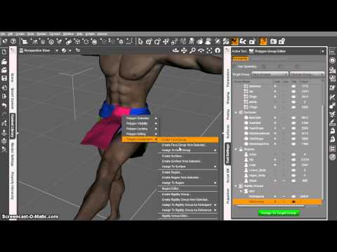

    Some other tutorials that may be helpful for rigging and morphing in general.
    Rigidity to Exclude Corrective Morphs
    Content support
    Part 1 - Joint editor
    Part 2 -Polygon Group Editor
    Part 3 - Weigthmap Brush
