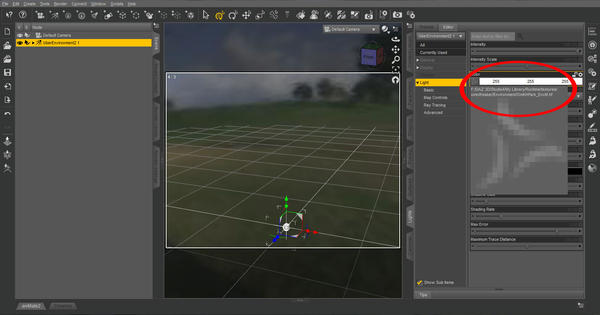

  • AkhbourAkhbour Posts: 0
    No, the sphere only gives you a clue on the light position (the brighter/brightest parts of the image and is nothing more than a .jpg.
    What you are looking for is the HDRI file, the one showing in the light tab of UE, should be in .tif 32bit format.
    You can edit that one in Photoshop or Gimp (I think) to add a black rectangle which covers the lower part of the HDRI.
    Browse to the location indicated by DS to open that file.

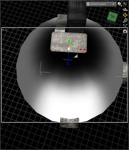

    For a scene like that, I would have created a map like in the first image.
    You apply a jpg version of the map to the UE sphere and align your prop with the bright parts (image2)
    And you get something like image 3 (only lit by UE) where you can add point lights to simulate light sources.
