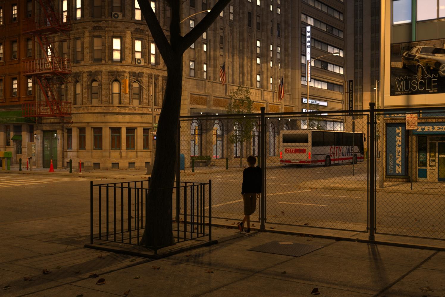

    I loaded building1Iray with the nightlight iray material. It came in black and I found that it loaded without a camera and in perspective it was looking at a wall in an alley :) Once I moved it to the street and set Environment to Scene Only it worked. To get the ligting right I changed the Film ISO to 200 and Shutter Speed to 60.
    A quick render.
    Click on image for full size.
    1496 x 997 - 2M
    Post edited by Fishtales on
  • Ah, I see! My problem is that it still looks sort of... plastic, in a sense? How do you get it to the point of realism as they show in the screenshots. The damp, wet street?

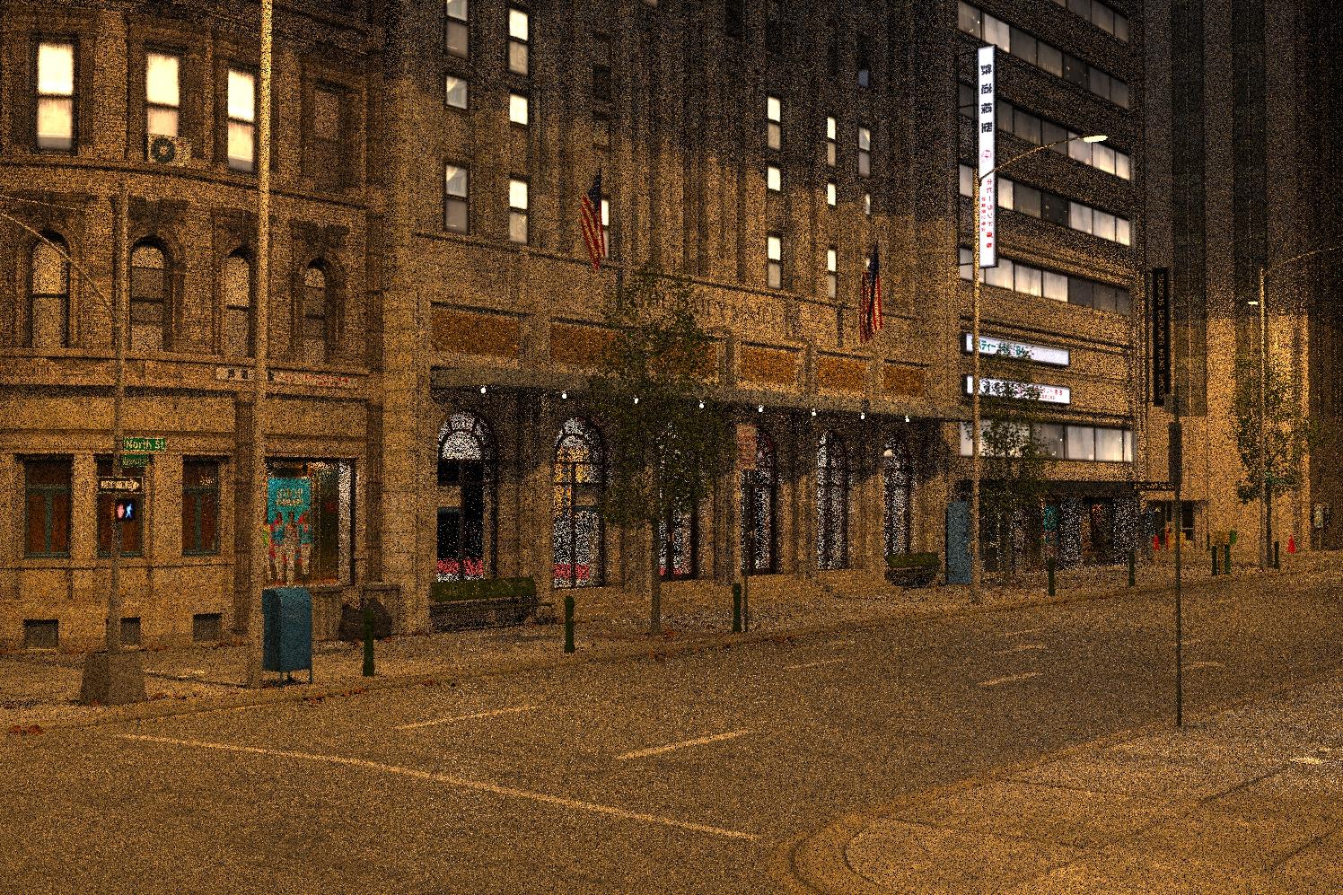

  • FishtalesFishtales Posts: 6,231
    This is a finished render I did after loading up the scene. To get wet streets try raising the Glossy colour.

    http://imgur.com/Nqq5fxe - that is how mine turned out.
    Here is what I'm coming up with. It has such a different look than yours. Yours is darker and well lit, mine is , in a sense, bleached with the closer buildings but evens out.
    ​I did correct my ISO and Shutter speed settings.
    It looks like you need to turn the Headlamp off on the camera you are using. Select the camera in the Camera Tab and turn Headlamp to off.
  • Oso3DOso3D Posts: 15,115
    Check your camera. It looks like the Headlamp is on Auto or On. Set it Off. ;)
    Also, I would HIGHLY recommend not using the fog. It will take forever to render.
  • Absolutely awesome. Got it looking good! Thank you guys a ton! Sorry for pestering. It seems as though the Headlamp was the root issue.
