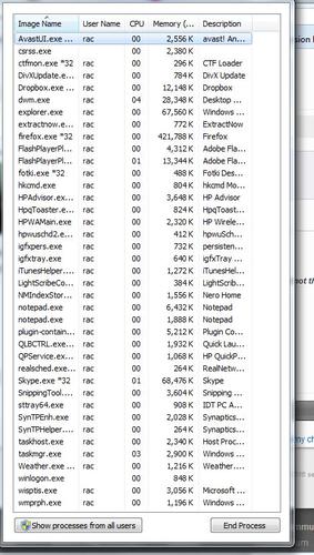

Mine doesn't seem to be working & it isn't in the task manager either.I tried uninstalling & re-installing & still isn't running.I'm on a 64 bit ,Win7 laptop though I have the 32 bit installed.I was curious how to get this running as I'd like to try to figure this out:)

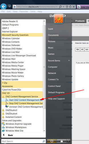

    If you are on Windows, go to the Start menu and there under DAZ3D should be a command to Start CMS

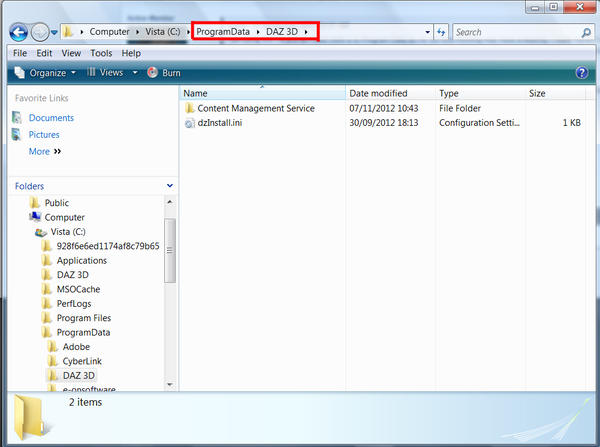

    Ok I am just thinking out loud....where is your CMS located, Program Files or Program Data....I am sure I read somewhere that some older CMS installations appeared in Program Files where as my last two clean installs (and I mean clean OS installs too) found CMS in the Program Data folder. You will have to Show Hidden Files to see the Program Data folder.

    Here you go Pen. My last two installs placed CMS in Program Data which I did find odd as the older version where in Program Files.
    1001 x 746 - 264K
  • fixmypcmikefixmypcmike Posts: 19,742
    Is the CMS executable there, or just the databases?
  • SzarkSzark Posts: 10,634
    edited November 2012
    Good call Mike just the databases...never thought of looking for the exe.
    Sorry about that but not having sleep for over 48 hours is taking its toll.
