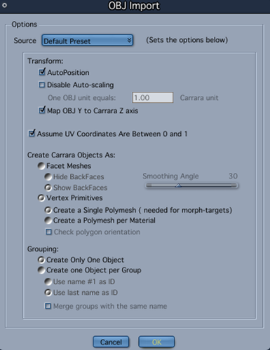

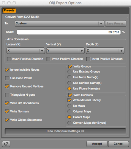

    Victory is achieved on this. Though animators will hate it...
    Export your genesis 2 figure from Daz Studio with the settings I have attached, and she will come into carrara as an obj file that has textures intact, and will render in global illumination.
    You can also get it worked with a rigged figure by exporting as collada - but it came in as a mess of files, and the genital prop was locked to something, and I could not sort it out. But that -might- be a clue for an animator who needs... 'adult' functionality for whatever.
    Now I can get back to sanity on some other project, the bug in my brain has been stepped on. :)
    Obviously on this forum, while I can upload an image of my settings... you'll have to trust me on the results and just test it yourself. :)
    Notice how I am NOT letting Carrara know this OBJ came from Daz... things got really weird when I tried using the daz preset, but my OBJ export was different at that time too - so I am not sure which end of this process is the important part that fixed it... :)
    (Now if I ever need this in a project, it will be like back in Vue 3 when the only method of import from Poser was obj, and so I had to be very particular about having all my things set up perfectly before taking them out of Poser...)

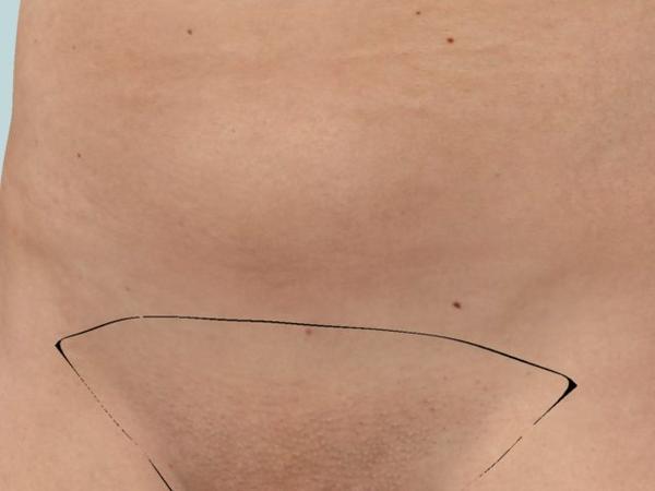

    When I loaded anything onto a rigged figure inside of Carrara, and did the double genital-prop trick, it seemed fine until I turned on global illumination and / or indirect lighting, or used a sky atmosphere.
    - At that point, there was a seam between the prop and body, visible as a curved arc along the top like in my screenshot.
    I can toggle the lights off, go back to basic lighting, and the seam goes away.
    I can repose to default pose or to something more intense (i played with a set of super hero poses I have for example) - and then unfit / refit to get it to sync up perfectly... but then if I add environmental lighting, the seam comes back. And unfit / refit doesn't fix it once there is environmental lighting.
    Since I'm not an animator - the obj solution is workable for the few use-cases I can come up with where I would need this prop. I'm on the side of realism and that means if I did any nude, a simple flat textured surface would be jarring to me for the female form.
    But for animators, unless we can get environmental lighting to not have that seam - genesis figures are a wash for anything with potential nudity.

    Been running some tests on the method put up by jerife (great work!). Initially I had the same issue as arcady, then the more I played with settings I kept getting Carrara lock-ups. Got so annoyed that I re-installed Carrara - surprised me in that it was painless - automatically uninstalled previous and reinstalled with serial and all runtimes unaffected. Took only a couple of minutes.
    Restarted Carrara and tried Genesis 2 Female / V6 with genital once more... works perfectly and even pose presets work flawlessly. Tried Genesis 2 Male, that also works just as well but does have a very slight rim of black on the texture (easily fixed in postwork). Only did a very quick check so maybe better textures or M6 may work better? I can leave that for another day, at least the solution works.
    Anyhow, I can make one small addition to improve matters. Edit the texture of the fitted Genital... set Alpha at 0% and everything else to none (makes it truly invisible), now you don't need to uncheck 'Receive shadows' on the textured Genital, shadows will then render properly. I also went one step further and set rendering level at zero, don't know whether it actually saves any resources (does Carrara actually render invisible things?) but it seems logical to me.

    To answer your question yes/yes/no. But in my limited experience I've never met a bad texture, i.e. one with gaps, that was magically transformed to no gaps just by changing the type of lighting? You have to find and fix the underlying reason for the defect in the texture.
    Maybe not so easy in this case since it could possibly be hardware or operating system related?
    As I said before, I had gaps in the gens texture for a while and I clicked everthing in sight, they actually cleared for a short time but then came back again, never worked out why, it just seemed to happen for no apparent reason. Re-installing Carrara was a last resort and happily it worked for me! You've got to find what works for you, EXPERIMENT. If you're unlucky maybe nothing will work, then you wait maybe 5 years to the next Carrara upgrade???

    But the issue in this thread is about the genital prop (which is why we have a thread talking about how to render something, and no actual screenshots of what we're talking about... :) ).
    The odd gap you see in my shots above - that's not a texture black spot, its an actual gap in the mesh. I could show you other camera angles where you can pan around that and see how the prop is not lining up geometry wise...
    - And it occurs anytime you mess with anything that impacts the figure.
    Wear some, change a pose, change a shader, change lighting - anything that effects the figure on screen, creates the gap in the geometry of the figure.
    But if you then un-fit and re-fit the prop, the gap goes away... unless there is global illumination. In that case... I guess something in GI does math on the figure after the refit, and that causes the error, that pushes the prop slightly out of angle.

    I have no gaps between meshes. I switched to wireframe views and inspected in minute close up: absolute alignment.
    V6 works identically whether Gens added (this method) or not! No tweaks, clicks, or fiddles necessary between poses or anything else.
