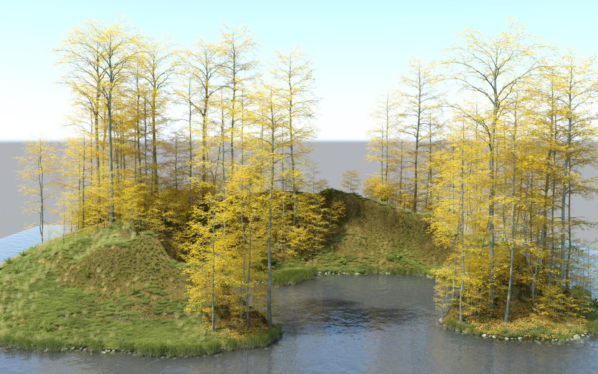

    Sorry, to bringing up this old thread, but I have a trouble with this set and could not find any other related thread.
    Most of the time renderings drops to CPU only and iray renders takes ages (Daz Studio Beta 4.14).
    It happens with UltraScenery scenes and only simple scene with the primitives renders on GPU.
    I have Nvidia card with 8 GB of VRAM on Windows 10 Pro, 32 GB RAM
    and have no problems with GPU rendering of UltraScenery scenes with different light setup.
    Anybody are still using this light solution or is it abandoned long time ago?

    Below is an example render (on CPU only) of the scene mentioned above.
    I really like images created with DA Real World Lighting,
    but dropping to CPU only render mode in iray is a big trouble for me.

    Ok, problem solved. DA Real World Lighting is changing the Optimization of instances to Speed
    and that makes the problem, because UltraScenery uses a lot of instances.
    After changing Optimization to Memory, iray renders are fast and on GPU.
