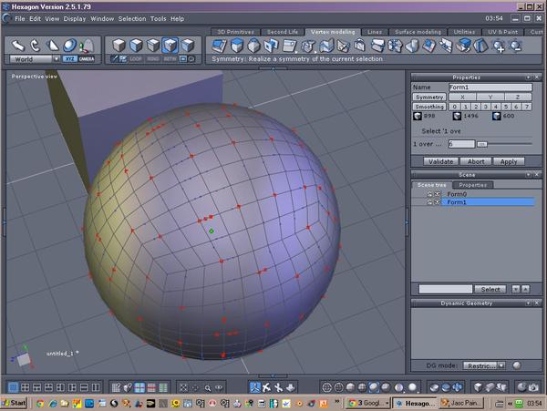

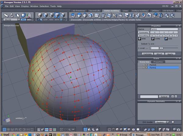

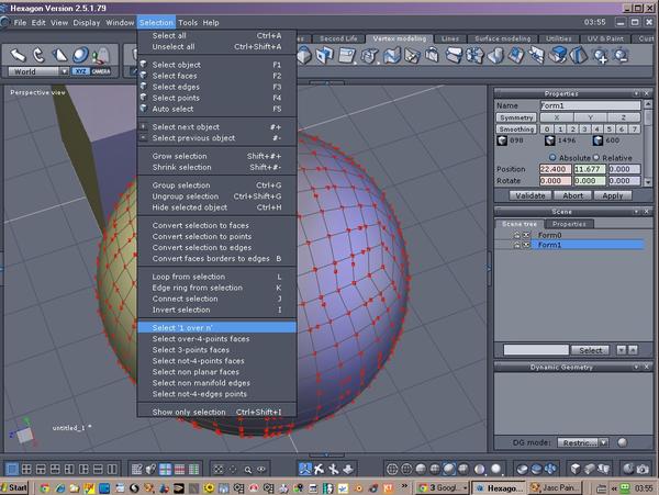

Not quite; If you select the 1 over n function you can do more or less what you are looking for, but not quite as you will find out when you try it.
Look in the top right pallet you will see the adjustment for selecting n
Again top right hand tool pallet showing adjustable n
You can do it with verts; with edges; with faces.
The above looks a bit weird because I happened to use an example with extra verts on the object. So when you try it shouldn't look so odd. Unlike other similar adjustment methods in Hex you cannot overide the whole numbers by introducing {typing} fractions of an n.
