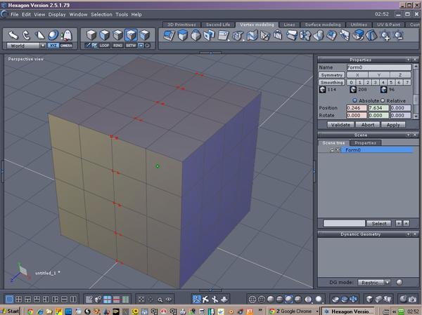

    I haven't seen that video yet nor do I remember the thread. However if the OP is using the latest version, couldn't he do exactly what he gave as an example and create and move a tessellation along an edge x amount. Then dissolve {back space} it WITHOUT removing the verts {ie none} which is an option if I remember correctly. This would then leave nicely aligned verts. ? or, am I having a silly 5 minutes. :down:
    Edit: Thus. :cheese:
    1018 x 762 - 190K

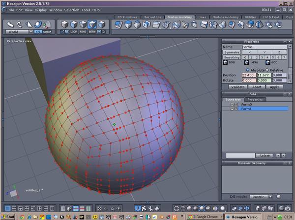

    Yet another one......
    1018 x 766 - 218K
  • RedSquareRedSquare Posts: 0
    and thus: Sort of random but all the same amount. But why would you want to do it ? :-S
