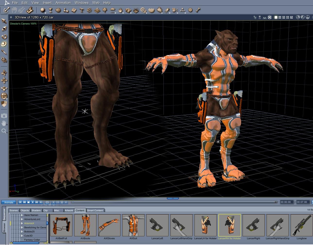

    Okay here... While typing I fired up my favorite 3D software, tossed in Midnight Stories' Lycan for Genesis, and then just looked for an outfit with shoes. Hmmm... Artemis X should be a challenge!
    Now Lycan has some wonderful creature feet - hence my saying that this will be a challenge. So on the left we see his feet without the boots, and on the right he's wearing the whole shabang!
    1289 x 1011 - 1M
    Post edited by Dartanbeck on

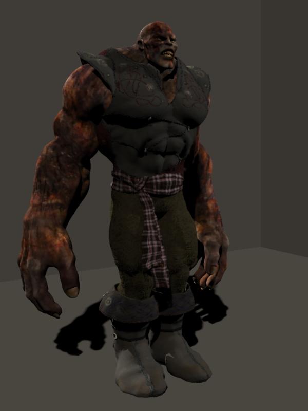

    This is Journeyer Scout on the Infernal Behemoth. I must say, I haven't been finding shoes that fit this big fella. He's freaking HUGE over people or the Gorilla.
    If you're looking for something specific, let me know. If I have it I'll check it out for you ;)
    600 x 800 - 119K
