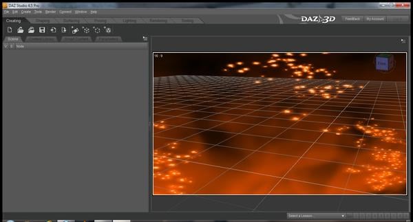

  • jestmartjestmart Posts: 4,449
    If you toggle on 'Show Aspect Frame' you will see that the background image is being displayed to the size of the render size listed in the Render Settings pane. In other words, "What you see is what you get (render)".
