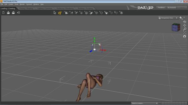

Hi everyone, after a long time I tried my hands on 3d yesterday. Today I dont know what happend to my ds4 that no figure, whenever i tried to rotate it after giving some initial pose is rotating about their own center. When i activate the universal tool also it appears far away from the figure's bounding box. I tried to open some other scene file but it still works the same way. Everything was working fine with that same file in the morning, i dont know if somehow i tweaked some setting unintentionally or whatever but this thing still persists even after doing a reinstallation of the studio4. The version i am using is 4.5.1.6 64 bit. Can somebody please help ??

  • JaderailJaderail Posts: 0
    @bellliee: Can you post a snap of your Viewport with a figure Selected? That will help me help you.
  • belllieebellliee Posts: 0

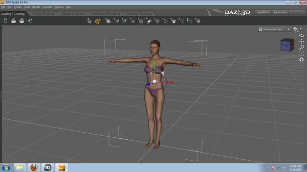

    Thanku Szark once again and Jaderail, here are the snapshots...
    In the second pic, the universal tool appears way above the bounding box and in the third pic when i tried to give the figure z-rotation it actually rotates about the point where the universal tool appears to be not about the center of the figure as it happens normally.

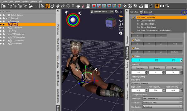

  • kitakoredazkitakoredaz Posts: 3,526
    if you have changed tool setting to rocal cordinate?
    activate universal tool , then open tool tab. from top menu.
    then check your universal tool setting.
    and If u use root node for rotate? I think it is better to use hip node to rotate figure,,
    the root node need to decide general base positon and direction of the figure in your scene
    after that, move your figure what you want from the positon, by hip node,
    then pozing detail by each bone or use poze preset (keeping the base positon)
    if you do that,, you can apply poze preset at the positon where first you set by the root node .
    this pic is genesis but it is same when i cneck with V4 and poze preset.
    (need to set pozing tool if you want rotate by gizmo with loacal axis by hip node,,and you
    can not use poze controller to rotate hip by loacal axis,, though you can rotate hip (full figure with axis)
    but hope to rotate by rocal axis,, manually rotate by pozing tool gizmo ^^;)
