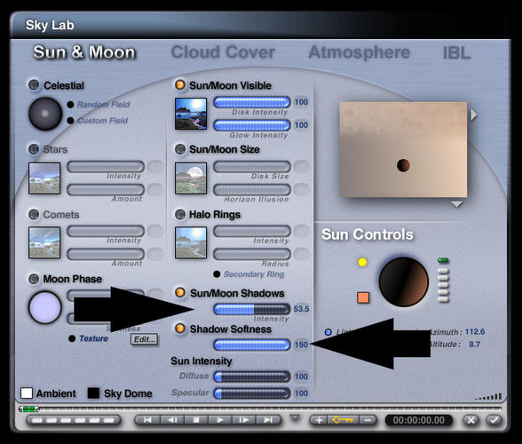

    I can offer some guidance for the Dragon Sky. If you want to radically improve the render time in regular rendering mode. Turn off soft shadows in the sky lab. (image right arrow)
    Also this sky was made before we had access to the extended lighting capabilities of Bryce 7. So I would recommend turning the shadow intensity up to 100 and putting in additional light.
    Or...
    Alternatively still turn intensity up to 100 but leave the shadow softness where it is, switch to premium effects, use soft shadow and TA rendering along with TA scatter correction and set the Max Ray Depth down to 4. Preview with 4 RPP and turn it up for your finished rendering.
