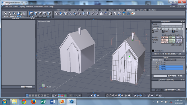

    This doesn't work. I cannot get it to do squat. I need the cabin on the right to be an exact reverse copy of the one on the left.
    553 x 259 - 125K
    1366 x 768 - 356K
  • Wee Dangerous JohnWee Dangerous John Posts: 1,605
    The main thing to remember is to change the Plus/Minus value in the Properties tab.
