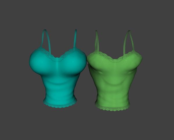

    I disagree greatly. The morphs work just fine.
    Blue is the original Poser figure with the G4 morph dialed up, Green is the autofitted version with the same G4 morph dialed up, yep that works, NOT!
    The deltas don't change when you autofit something, they still move the vertices the same distance, the problem is the starting point is different so the morph never looks like it did with the original mesh. Adjustment morphs might still have some value, but most of the main shapes are a waste of space, to make matters worse (or better considering how far off they are) they don't even "auto follow" so your still using the auto generated morphs.
