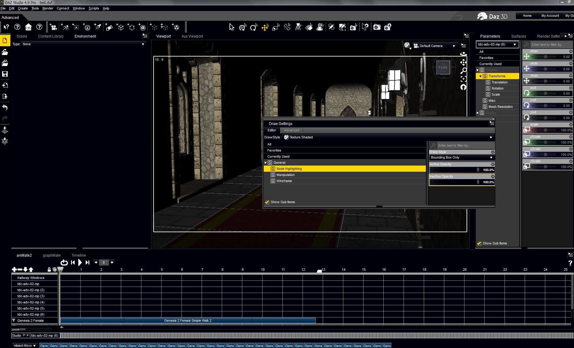

How can I quit the yellow thing while moving the mouse?
How can I quit the yellow thing preview while moving the mouse in the scene? It's possible?
Thanks!
    Go to the item in the scene tab and next to it, there is a small check, click it to an "X" and it won't be selected when you move over it.
  • Draw Settings pane, under Node Highlighting set the Highlight Style to Bounding Box Only.
    I can't find that FSMC crying
    You mean device setting next to preferences?
    Thanks!

  • Draw Settings - Window>Panes (Tabs)>Draw Settings.
    Thank You Richard I been wondering how to turn that off myself
    just like you said I found it under
    Windows> Panes(tab)> Draw Settings
     then found general > Node Highlighting, then I clicked Bounding box only .. Poof . worked like a charm

  • EtriganEtrigan Posts: 603
    While the yellow shadowing can be annoying, I found I missed it after turning it off, and turned it back on. I found I'd become reliant on it for:
    1. Final camera check (positioning) from the image camera after turning headlight off.
    2. Confirming position and orientation of a background object. The full model can be seen even if mostly hidden.
    3. Confirming object identity; where multiple instances of an object exist. Visually see correct selection, then pop up shows name (primarily used to parent/group objects).
    4. Confirming positioning; it's easier to see if/how much an object is below the floor/surface upon which it sits.
    Sometimes our worst annoyances serve a purpose.
