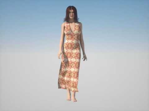

    Here is the "Sexy Walk" cycle clip that I was working on, rendered in a number of ways: (Ugh, the preview image looks awful!)

    thanks for the preview, can't wait for the official release
    Awesome walk! And you've even put in some beautiful hip rotation! Bravo!!!

    Phil, it's really....hmmmm....cheeky
    Walk Designer can't do that !
  • argus1000argus1000 Posts: 701
    Nice walks, Phil!
  • PhilWPhilW Posts: 5,162
    Thanks guys!  I start with making a basic walk and then adding some character, including this "sexy walk". There will be a run as well.  And this is just the walk chapter.
