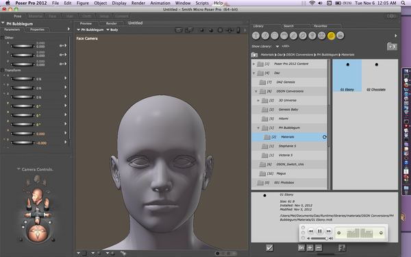

    Okay I did exactly as you said and this is what happens. (Screenshot)

    On this particular hair, I noticed that it does not bring over textures if you are saving the PCF as textured.
    The transparency is set to 1.0 in Poser and the hair not seen.
    If you had brought over the untextured model, it would appear as such.
    You will have to save one or more of the hair shaders as material presets and bring those over as companion files and apply them
    Apply the color you want, hit add button in lower left and save as "Material Preset" then make PCF .mc6 from those and apply in Poser

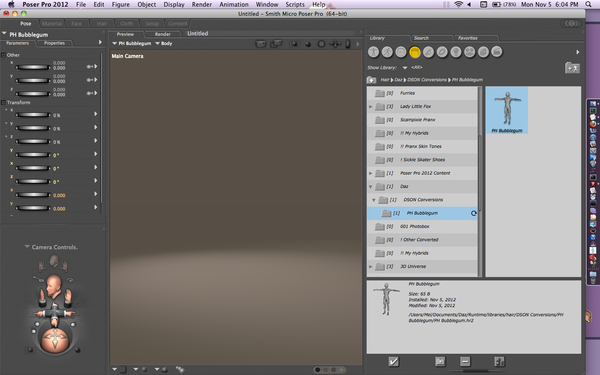

    Okay hmm.. I did this, and the hair shows as having 'None' in the material room. I can't add anything to it.
    It's completely invisible, even though I have tried parenting it to Genesis's head.
    If there aren't any materials, is that why it's not showing up? Or is it something else causing the dials to be all at 0, including scales?

    If you switch to wireframe preview can you see the hair's mesh?
    Try to reload the material :
    select the hair - click on the little triangle in the top right of the preview window - select "reload textures"
