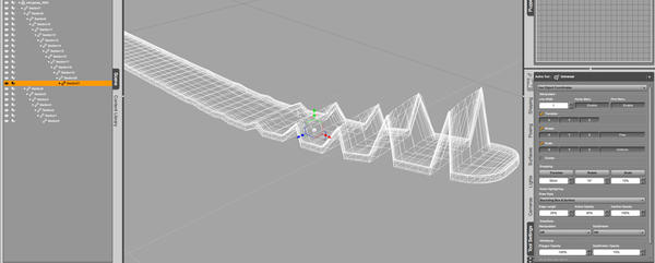

The first image is a purchased guitar strap (first image) that I wanted to change the rigging from bones end to end to two bone sets starting from the middle with an IK movement on each section on the ends. It actually works as I wanted but I get these protruding wedges from each bend point when they are bent. (see 2nd image) what is that???

    actually the first image didn't post so there are two images of the result of the bend, The first image should be perfectly straight. You can get the idea, though.

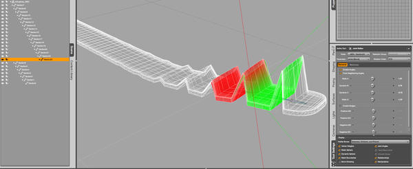

    Here are 3 shots. One flat with a Bend Joint selected. 2nd one is the same joint with tht IK bend. The third is a different joint selected closer to the front of the chain.

  • ValandarValandar Posts: 1,418
    It looks like the weight maps aren't fully assigned, actually. Maybe, since it's a flat strap, try assigning each bodypart 100% to its own bone, then smooth the result at 100% and 2-6 repetitions?
  • Richard HaseltineRichard Haseltine Posts: 111,992
    What happens if you use the Joint Editor to tweak the angles - the lines coming out from the centre point? What you are seeing is very odd, as it doesn't appear to be directly related to the visible weighting of the mesh - though it is clearly spiking at group boundaries, so it may be something to do with the way the parent and child influences are combined. I assume the last screenshot shows multiple joints bent - it may be easier to see if you bend only one (or two adjacent if that's needed).
