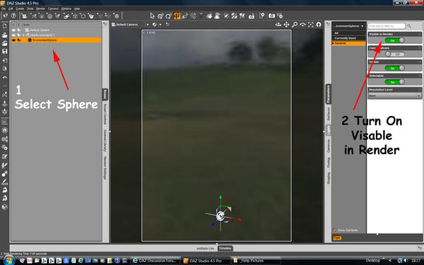

Thanks Szark.! Parameters tab! I saw the Visible in Render for the light but must not have looked thoroughly for it for the sphere. That rendered it.
