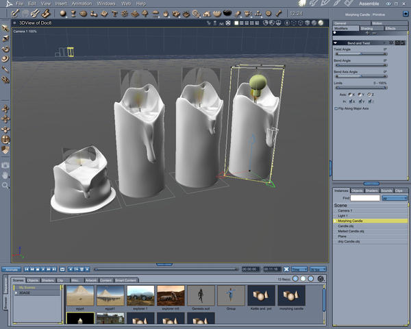

    Quick pix :
    Here's a morphing candle, ...the original model, and the re-imported obj;'s of the exported morph states.
    hopefully you can see the modifier tab, which is set at 0.
    Hope it helps ;)
