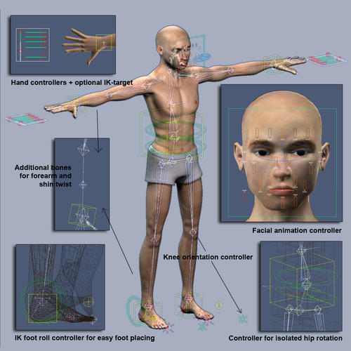

    I've created many rigs in the past with basic Carrara built-in methods and also with ERC advanced methods.
    I have attached a screenshot from an experimental Carrara-ERC-Rig, which was created to find out
    the limits of ERC and if it can be used for character animation.
    A foot roll controller like the one Joe posted, is in a basic form even possible with Carrara built-in methods.
    but if you want to have create some more advanced controls inside of Carrara, you need ERC.
    Another way to use advanced animation controls inside of Carrara is to make yourself familiar with the creation of CR2or DUF characters. I had several experiments to include my controllers inside a CR2 with quiet good results.
    The major disadvantage, which Carrara had compared to other software packages, is that not all effects do show up in real time, but only after releasing the mouse button. This is for all 3 control methods: Carrara-built-in, ERC and CR2-built-in controls.

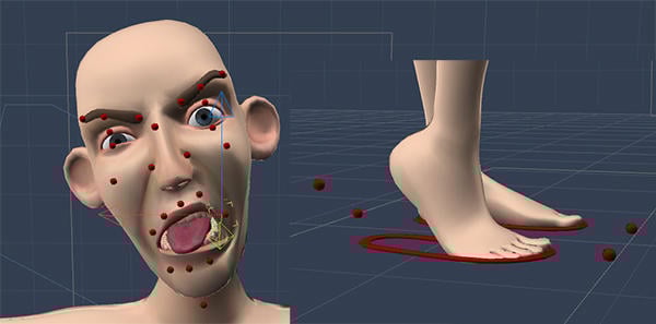

  • fabafaba Posts: 53
    And a screenshot of the animation controls build into of a CR2/ poser file
    600 x 297 - 116K

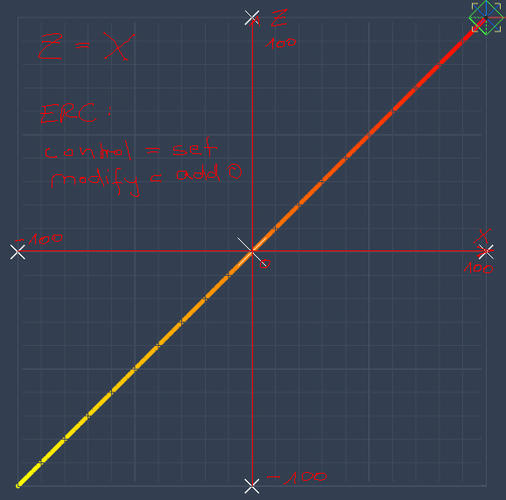

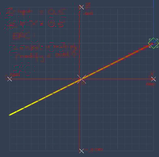

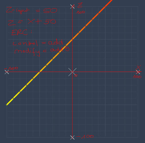

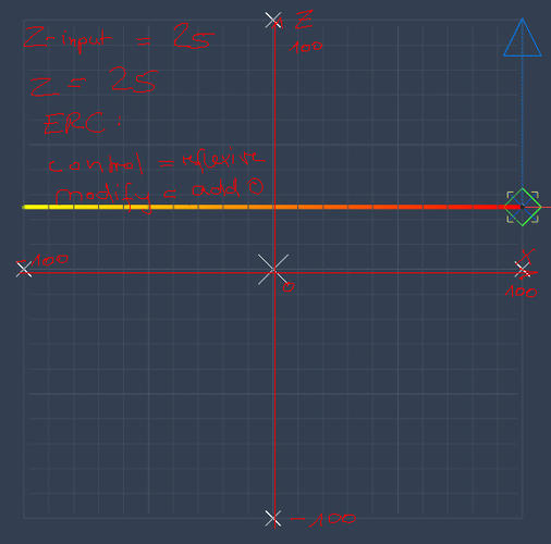

    I have setup a test scene to show what the different functions will do:
    This is a basic coordinate system. It has a range from -100 inch to 100 inch. Horizontal is x and vertical is z.
    I have set up an ERC-modifier that way: x is the driver and z is the driven parameter.
    x values start with -100 and end with 100.
    I have set up a few examples to show the effect of the modifier:
    1. "Set":
    The z value is driven by the x value with the "set" control.
    The corresponding graph function is Z = X
    Input values x: -100 to 100
    Output values z: -100 to 100
    2. "Add":
    The z value is driven by the x value with the "add" control.
    the corresponding function is Z = Z (old) + X
    z (old) value : 50
    Output values z: -50 to 150
    3. "Multiply":
    The z value is driven by the x value with the "multiply" control.
    the corresponding function is Z = Z (old) x X
    z (old) value : 0.5
    Output values z: - 50 to 50
    3. "Reflexive":
    The z value is driven by the x value with the "reflexive" control.
    z (old) value : 25
    Output values z: 25
    578 x 571 - 144K
    578 x 571 - 143K
    578 x 571 - 139K
    578 x 571 - 144K
  • thoromyrthoromyr Posts: 452
    Fenric said:
    Reflexive sets ERC so that the value source and destination are the same, where you want to modify a value based on itself rather than based on something else.
    So it only does something if the modify does something other than add zero. So would modify of multiply and providing a value of 0.5 result in the actual value being half of what was set?
    Thanks for the illustration. I should've thought of just using coordinates to simplify matters...
