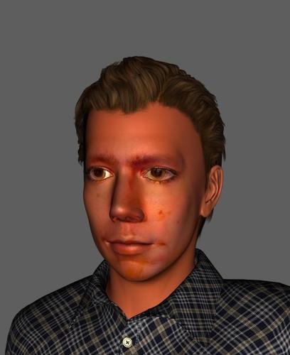

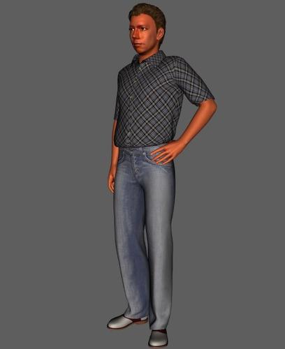

    Squirt, here is your Genesis version :)
    done in FaceGen... I just could not resist because those pictures are so perfect! It's the first time I've ever tried doing it.

    I really didn't do anything except move markers around the three photos. It's not a perfect rendition, but it's close enough that tweaking to get accuracy would be fairly easy.
    I bought the FaceGen exporter a while back, $99 as I recall, which gets a Genesis head morph. The only real issue is that the eyes get misshapen from FaceGen... but that can be corrected with a little effort.
