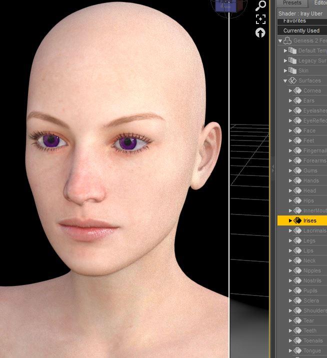

Hey guys. Here are 2 images, before and after rendering. See the difference? What am I doing wrong? I'm sure a lot of things but start with punches, heavy kicking can come later =)
Also, I will appreciate good links to Renderin tutorials, I'm getting lost in searches.

    I'm not understanding the question. What is "wrong", what you expect to see?

    The  difference I see is in the eye colour  & the way the stomach tattoo looks so  my *guess* is that you are rendering 3DL materials in Iray & not everything auto converts well.
    It could be helpful to have more details (or link to the character you are rendering)  & know which render engine you are using (Iray or 3DL) & how you are lighting your image then if the Video doesn't answer your question someone that has this product might chime in with better advice :)
  • prixatprixat Posts: 1,630
    Hi Zom
    If you're asking why the viewport is not a good preview of the render...
    We'll eventually get live rendering as processing power increases, for now we get the quick viewport and slow renders.
    (As the lighting gets more and more complex the preview gets less and less accurate.)

    Take a look at the eyes & the lights. The eyes on the screenshot are purple (custom made, but the skin seems to work, the eyes don't). The lights are too defferent also, so much that the change the shape of the face.

    Are you rendering in 3Delight or Iray? Can you post a screenshot of the Rendersettings? The Environment tab of the rendersettings is needed.
    Also, if the eyes are supposed to be purple, what surface did you apply the purple colour to? Is it the Iris or the sclera? Is the texture converted to Iray? What lights are you using in the scene? Is the headlamp on the camera turned to "off"?
    On top of that, the preview window is using a different way of calculating the output compared to the final render. So the result looks almost always differently.
    EDIT: Here's how the settings have to look in the parameter tab once the conversion to Iray has happened, so you get violet eyes in the render:

    Thank you everyone for everything I have learned from you. With your help I was able to resolve that particullar issue & learn quite a few new things. And now I have 100 more questions, but sinse not all of them are structured in a polite manner, I'll save them for now...

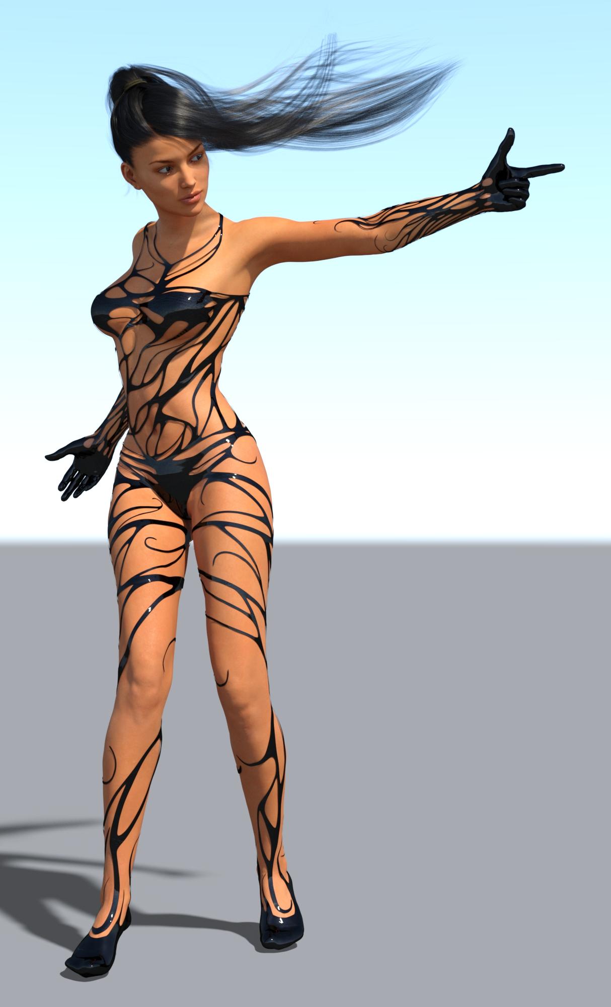

    In 3Delight I am rendering in seconds.... I am not kidding, the image attached has a bit higher quality rendering settings then in previous one & it was rendered under a minute... But it is missing some Iray magic... Perhaps when I learn precisely what does what, I'll be able to encrease attraction factor in my 3 Delight renders. For now this will have to do.
    Again, thank you everyone, you've been a great help & BeeMKay, you have my dippest gratitude wink Thank You.
    700 x 910 - 327K
  • BeeMKayBeeMKay Posts: 7,019
    edited August 2016
    Have you added lights to your setup? A render time of mere seconds usually means you forgot the lights. wink If you did add lighta, for 3DL lights you need to switch shadows on, they aren't doing it by default. Also, 3DL quality settings are different from Iray settings. When I started out with DS, there was only 3L as render engine, so I learned "from scratch" doing light setups. That was really long and painful learning, with lots of cursing, and I still learn. But learning how to do the lights from scratch is worth it. smiley
    Still, 3DL and Iray are different. 3DL has a warmer feel to its renders, even though you can get very realistic with the output. Iray, as I mentioned, is crisper.
    In the current tutorial sale, in the 70% off section, are a couple of free vids that explain pretty well about 3DL. http://www.daz3d.com/learn-to-strike-a-pose-featured-70-off-tutorials
    About your card, you can check out if you can render Iray with it, if you go to Render Settings and click on the "Advanced" tab. If your card shows up, you need to check it, so that it is used as render engine. Also, check the Optix acceleration. But to my knowledge, Radeon cards don't do the Iray rendering thing.
    As for the lady, she's wearing this (which was very discounted at the time I bought it): http://www.daz3d.com/tangled-outfit-for-genesis-3-female-s-and-genesis-2-female-s
