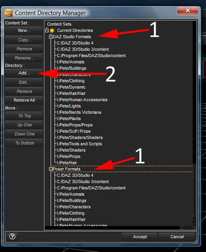

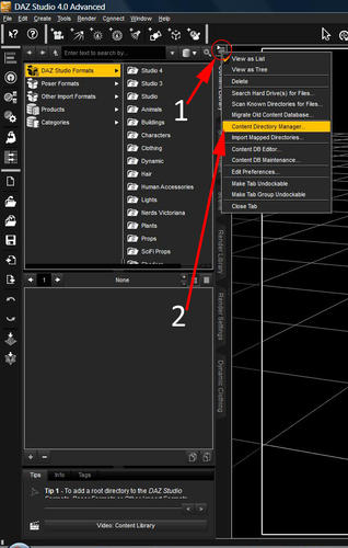

  • SzarkSzark Posts: 10,634
    edited November 2012
    joea64 said:
    OK, so if (1) I've already installed Daz on both my desktop and laptop, and (2) I have a lot more stuff installed in the "Studio/My Library" folder on my desktop than on my laptop, assuming that I copy over the contents of "Studio/My Library" to an external HD, how do I tell the Daz Studio installation on my laptop to start looking for content on the external HD instead of the machine's internal HD?
    Yeah what Jad said. Here is how to do it.
    Whilst in the Scene Pane follow the images. When you get in to the Directory Manager just click on Daz Studio Formats and "ADD" your new location, do the same for Poser.
    525 x 640 - 191K
    647 x 1018 - 202K
    Post edited by Szark on
