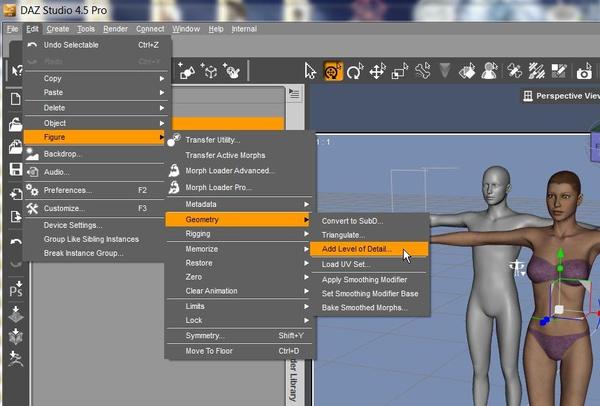

  • DAZ_bfurnerDAZ_bfurner Posts: 62
    Here is the function. You need to make sure you have the LOD files for that figure. See the image below.
    859 x 581 - 132K
  • SzarkSzark Posts: 10,634
    Yep did all that Blaine and I have all the LOD's. The LOD loads but as soon as I choose an LOD in the Parameters Pane, V4 disappears from view.
  • Richard HaseltineRichard Haseltine Posts: 111,680
    What preset did you have selected in the import options dialogue that appears after selecting the OBJ file? It needs to be the Poser preset.
    Perfect Richard, thanks that worked a treat. Who'd a thought it had to be a Poser preset. ;)
