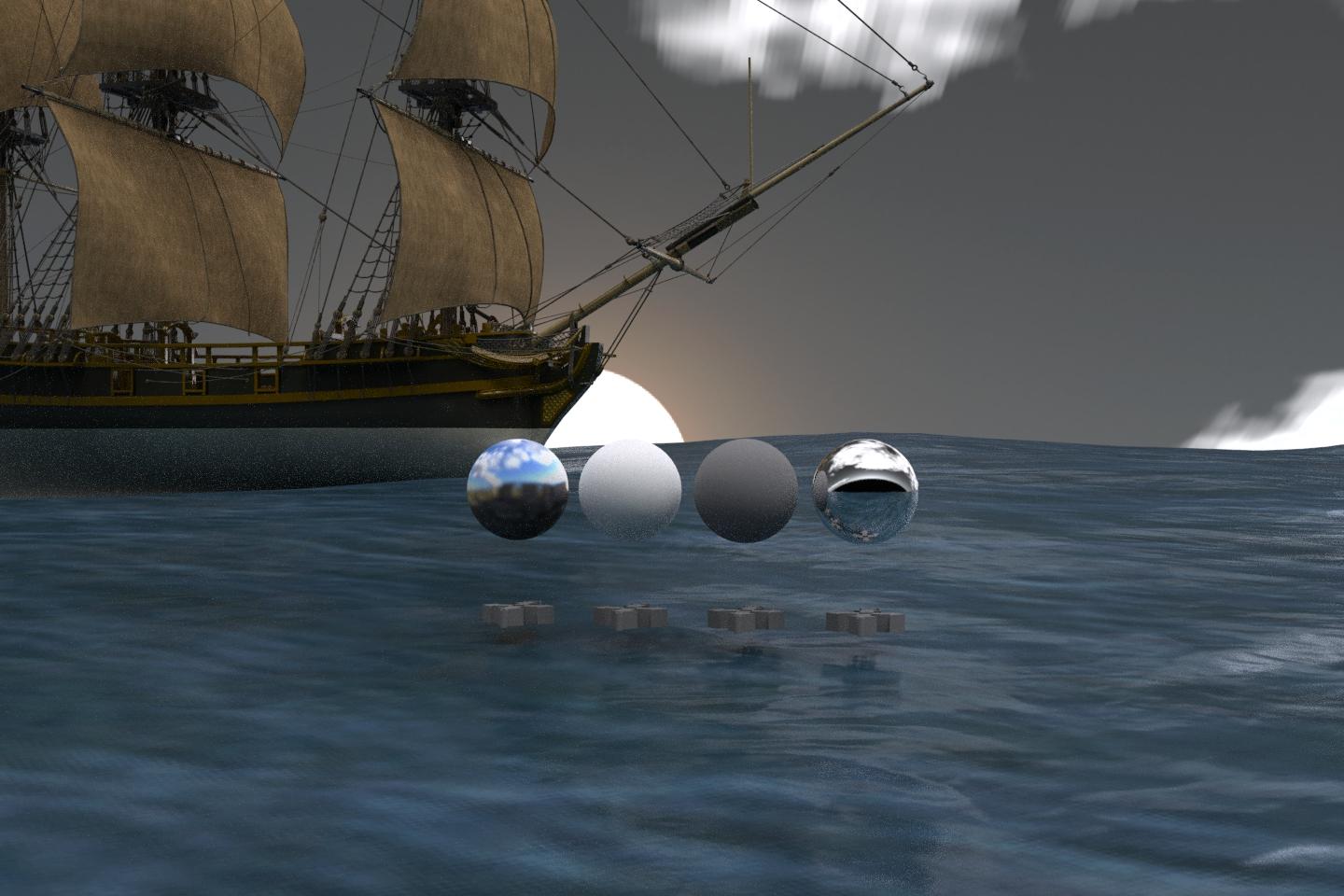

    Some fun I had a few weeks ago testing Refraction/Reflection using a cube. There are three cubes stacked. One for the water, one for the surface and one for the walls. I used the Geometry Tool to hide some faces on some cubes and make new surfaces on others. Why three cubes? Because there are three different elements with differing IOR settings. Hard walls at 1.5, Water at 1.33 and air at the surface at 1.0 which is the bump map in the Cutout Channel for the wave shadows. Caustics are also turned on.
    Click on image for full size
    How did you position the cubes? Are they exactly aligned, or is one inside another (and if so, how big of a gap), or do they intersect?

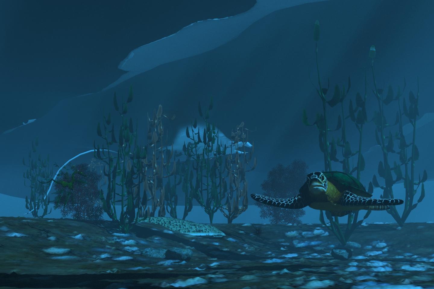

  • Oso3DOso3D Posts: 15,115
    Underwater, I find SSS is incredibly finicky with light and camera.
    It took me dozens of adjustments, moving the lighting angle, adjusting SSS, to get this. Sometimes I'd get no sss effect, sometimes everything would go nearly black (why? I HAVE NO IDEA), sometimes everything would be a giant fog.
    Really happy with the result, though!
    http://willbear.deviantart.com/art/Undersea-Scene-629635438
