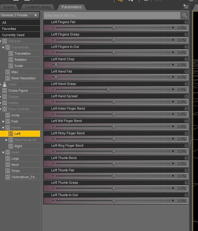

In Poser I could select a hand and there would be a variety of hand poses that I could apply to just the hand. Is there something like that in Daz?  I'm working with Genesis 3 Female. Would I buy "All Hands Poses for Genesis 3 Female" and that would be like having all the default basic hand poses in Poser?
  • BeeMKayBeeMKay Posts: 7,019
    edited August 2016
    If you go to the Parameter tab, you have sliders that control some basic moves the hand can do, which come with the base character.
    The "All hand poses" gives you the poses with a single click, rather than having to dial them in the parameter tab yourself.

    One note - if you select the hand itself, or the fingers/finger digit, in the Parameter tab you will find dials under "General" that control each joint, and allow you to bend, twist, etc. each "bone" separately. This is especially useful if you have to adapt poses to different situations.
