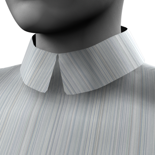

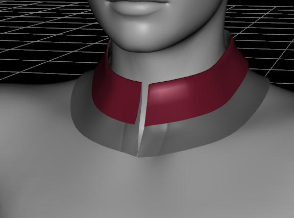

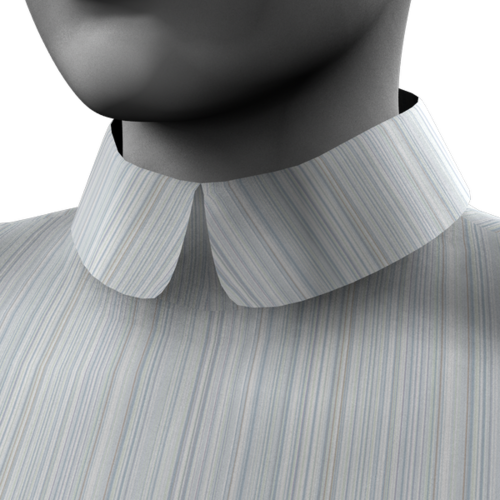

    Collar no smoothing. (Picture 1) Collar smoothing set on 5 (Picture 2)
    600 x 600 - 533K
    600 x 600 - 537K
    It looks like your corner areas are each two points of a four-sided polygon. That's lower poly than you'll want it to be, but I don't think that's the issue as much as the shape. Smoothing is interpreting the two points as part of a curve, so it tries to make that area into a curve.
    This first pic shows a test collar with smoothing off and the second with smoothing on. In this each collar point is the sharp corner of a polygon rather than a pair of corners. Smoothing does not interpret this as a curve, so it looks sharper when smoothed. Try that, or add a triangle past each of those two edge polys?
