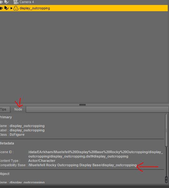

    You can actually find the name of the product in the node information when you select the item in question, if the product has Metadata.
    543 x 604 - 32K
    Very interesting answer. Thank you. Still, I'm a bit confused.
    ​When the Compatibility Base says the following: /Genesis 3 Female Basicwear/Top, where should I look to find the product?
    ​Option 1: I went to my Hardrive > Users > Public > Public Documents > My DAZ 3D LIbrary... but there is no such path like /Genesis 3 Female Basicwear/Top
    Option 2: SmartContent. Same, no such identical path.
    ​Option 3: ContentLibrary tab: same, no such identical path.
    ​Can you please give me a concrete example on how to go from the path in the Node tab to finding the element again...

  • BeeMKayBeeMKay Posts: 7,019
    Check out what it says in the scene ID, that's the first line above below the Metadata. It tells you exactly where the file is located. However, it does not tell you where the material is stored and such, but you'll usually find them in the Runtime/Texture folder. There, it usually helps to know who the creating PA is (in my example EARKham, and locate the folder for that artist.
    The data subfolder usually contains the user facing files for DAZ Studio only geared duf files from "DAZ Studio Formats". It doesn't contain any materials, morphs or geometry. Those, you will find in the Runtime directory. The geometries subfolder of the Runtime folder contains the actual meshes. The libraries subfolder contains the cr2 user facing files for Poser geared content (which can be used by DS as well, but that shows up in your "Poser Formats"). Then, there's the Textures subfolders, which contains all Textures. Note that Geometrie and Textures folders are used by both, DS and Poser items.
    Also, I see that you have a Content folder in your DAZ  directory, which probably contains a Runtime subdirectory? If yes, please copy the content out of the Content folder and relocate it one level higher, merging it with the existent runtime folder. Otherwise, it might cause hiccups.

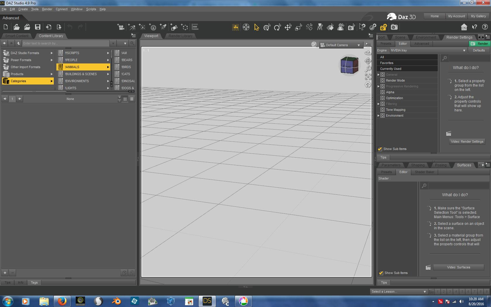

    Let me pull up my studio and i will take a screen shot for you. The categories won't break any links because they don't move any files they just create a link back to the original file.  Its just a link that you can organize in a manner that makes sense to you.  So even if you delete the category link, change the name whatever, nothing happens to the main file.

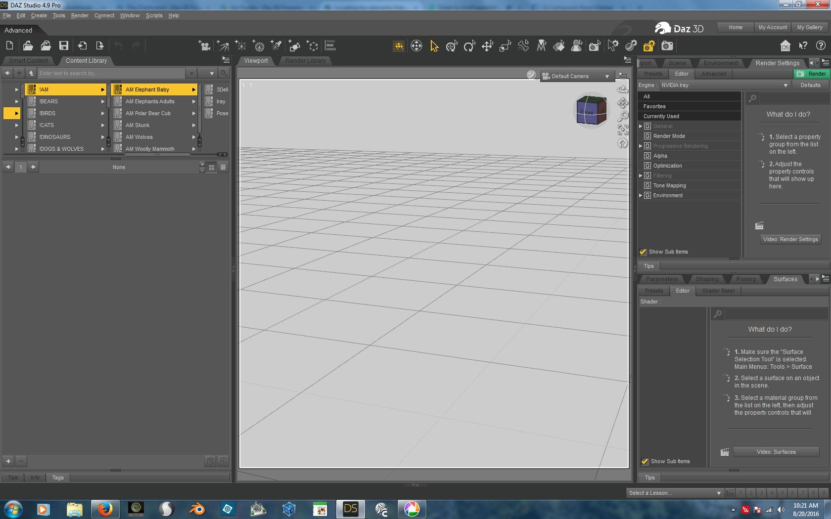

    Okay in the first one you can see where you go to create the initial categories.  Right click on the categories title and hit create sub category.  You can create as many categories and sub categories as you want and as many sub sub categories under each category as well.  I included a second screen shot to show you what I mean. What I do when I purchase or load new content is first track it down (that's the hard part, but worst case scenerio, I like in the file structure of the zip and that usually tells me where its at.  Like it might me under people, midnight stories, genesis2 female, hair, pretty long hair, or whatever.  this works for both daz side of things and freebie poser side of things.) Ones you have found your item I right click and highlight the thumbnails of the items and hit create subcategory.  this will pull up the categories box and you follow you category links until you find the spot you want to create the new one in (i.e. right click the thumbnails, click on create subcategory, box pulls up follow your category structure to people, genesis 2, female, hair and then create your new category for your pretty long hair or however you set things up)  Hope that helps!
