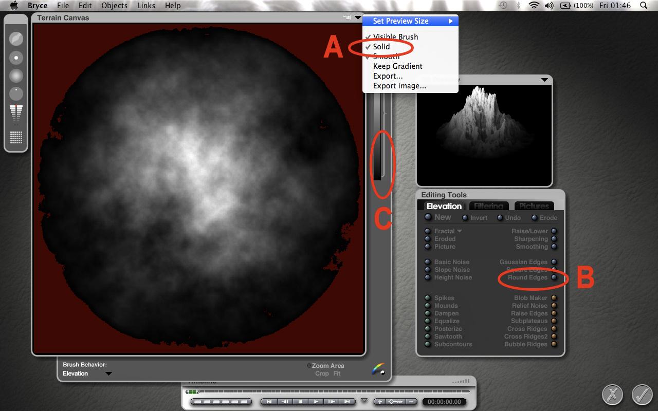

  • Dave SavageDave Savage Posts: 2,433
    edited August 2016
    Not really sure what you're asking here. A picture of the problem would help.
    In general, yes you can create circular terrains. First thing to check is that your terrain is set to Solid (see 'A' on screen grab below).
    There is a Rounded Edge filter in the terrain editor which will create a roughly circular edge to your heightmap (see 'B' on screen grab)
    Finally, you can use the cut off filter slider to make anyhing below a user set height invisible (see 'C' on screen grab).
    Hope this helps.
    1280 x 800 - 263K
    Post edited by Dave Savage on
