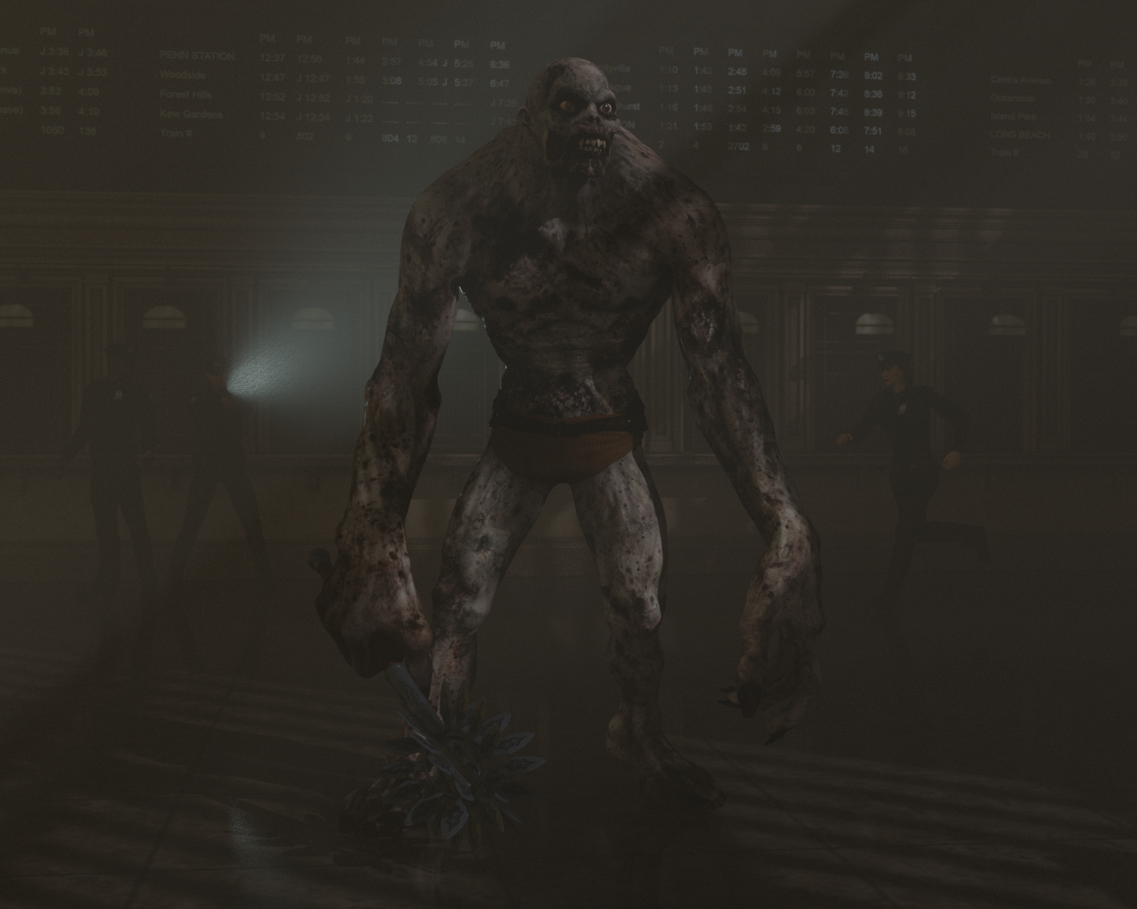

    Basically, you want to turn a spotlight into something that looks like how a flashlight acts where you can see the cone of light and not just where it hits the ground.  I haven't seen any products that do this.  I tried to do something similar in this image:
    As you can see, I didn't quite hit the mark.  I'm still trying different techniques.  In this image, I used Expanded Godrays for Iray by Sickleyield and Marshian and attached that to the flashlight from one of the sets here.  The flashlight did have a light that could be turned on, but it had the usual problem in Iray where you can see the light at the start and where it hits the ground, but not in between.  I had to make more unique opacity map for the light cone so it would look more like light from a flashlight.  I'm still playing with it, but it has moved further down on the list of things I want to figure out.  To get this to work, the opacity mask would still have to be tweaked more and possibly using bloom which I didn't for this image.  One of these days I'll get back to it.  It would be nice if some enterprising vendor came up with this.  I haven't seen any flashlight models where the light works like this in Iray.  I've seen lights like this in 3Delight so I'm assuming there is a way of tricking the light in 3Delight to do this, but I'm not that good with 3Delight yet.
    But, it you have the Expanded Godrays for Iray, I would start there.  If you happen to find an actual prop that does this, please let me know because I could really use one!
