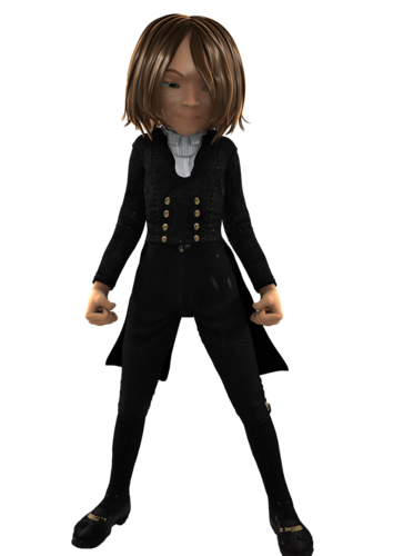

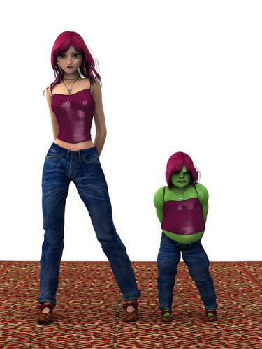

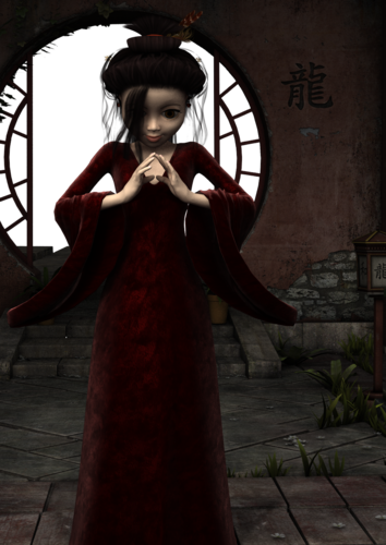

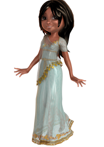

    Hi Jade, when you buy the gen 3 iconic shapes you get autofit for them. I have autofitted a lot of Gen 3 stuff to genesis. Here's a few
    Sam character wearing edwardian suit
    Mavka/kiyoko mix with chiton
    Playing with the dress
    kiyoko in the dna morphing gown for v3

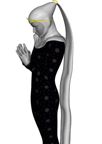

    It's a mophs for V4 by morphs loader, but the same method works with gen3 morphs
    744 x 846 - 432K
