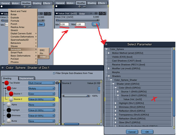

    Hello Thoromyr,
    I've set up a simple scene for the effect you are asking for:
    I added a simple color shader, which has a value (0-100%) multiplied for the brightness.
    This value (0-100%) is going to be controled by an ERC Slider from the object's modifier panel.
    I have added a simple vertex object sphere and added a Behaviours>Slider modifier.
    By hitting the "Set" button i opened the window for the parameter to control by the slider.
    I found the value (0-100%) under Shaders>"Shader name">Shader>Color>Source 2>Value (Val) [re32],
    selected it and hit "OK".
    I changed the minimum of the Slider to 0 and the maximum to 1.
    The greyscale value of the shader (value (0-100%) ) is now controled by the slider.
    unfortunately the result is only visible in render and not in the preview.
    Here is the example scene
    http://www.sharecg.com/v/65324/view/5/3D-Model/ERC-Slider-controls-shader
    774 x 595 - 174K

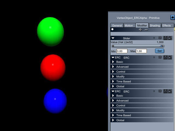

  • fabafaba Posts: 53
    Hello Thoromyr,
    I have set up a simple scene with both a reference shader and an ERC link to control the alpha of 3 shaders of an object
    for comparison.
    For me both setups do not update in the 3D view (both OGL and software), but as you mentioned the ERC shader updates at least
    in the shaders tab and the shader room.
    For the ERC link I have linked the alpha of the first shader to an ERC slider and the alphas of the other shader via a regular ERC modifier.
    I have animated both with an oscillate tweener to make the change more visible
    http://www.sharecg.com/v/65363/view/5/3D-Model/ERC-controlled-Alpha-Value
    320 x 240 - 147K
    640 x 480 - 64K
