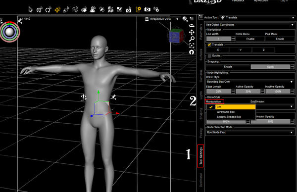

  • SzarkSzark Posts: 10,634
    From your description it could be Draw Style.
    Follow these steps
    Open Tool Settings found under Windows > Panes (Tabs) > Tool Settings and follow the image
    1207 x 781 - 350K

  • FSMCDesignsFSMCDesigns Posts: 12,858
    Thanks so much! That wasn't actually it, but it gave me the right place to look. It was under skin binding, optimized to full.

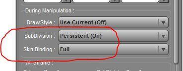

  • niccipbniccipb Posts: 483
    Hi...
    If you also change the Subdivision to Persistent (on) then you should not see any mesh shifting at all, other than what should move.
    Hope this helps... :)

  • RKane_1RKane_1 Posts: 3,039
    I can't find it in Tool Settings. How do I get there?
    Hi...
    Make sure you have something like the universal manipulator selected. The regular arrow selector won't show the 'during manipulation' settings.
    You can select it either on the tool bar or in the Tool Settings pane in the drop down window at the top of the pane.
    Once set, it applies regardless of which manipulator you are using.
    nicci... :)
    Glad I could help...even though I was wrong. LOL

  • cosmo71cosmo71 Posts: 3,609
    Follow these steps
    hello mr. szark, what a design for ds4 is this?
    Hiya cosmo. To be honest I have no idea what it is for. For me it is annoying. :) I will go and ask my collegues and get back to you.
    This is what Jad said about what Draw Style could be for
    Jaderail said:
    Draw style can be handy when working with large scenes. If your response is slow when moving items changing the draw style to a lower setting will get faster response and let you place items easier. I have to do that with the Forest Ultimate set.
  • edited October 2012
    niccipb said:
    Hi...
    Sorry but I just cannot find this "persistent" parameter by opening the tool icon or the universal section. Would you please be kind enough to guide me step by step in finding this param:
    I'm assuming I have the figure loaded and Genesis or V5 body parameters showing. Which precise icon on the parameter or other sections do I press please to get the dialogue to pop up as illustrated in your post? At the moment I am clicking on the circular tool icon at the right hand side of any of the V5/V4/V3/Voluptuous etc etc master morph sliders but the dialogue I get is "parameter settings/unlock/lock then in the box for parameter settings I see "sub-components", "controllers" and "keys"> I don't see any mention of "subdivisions" or "persistent".
    Thanks for your help.
    Edit: Oops, I see now. It's the Tool SETTINGS icon, not the tools/universal icon. Apologies. When different users have different user interface set ups menus and layouts look different.
