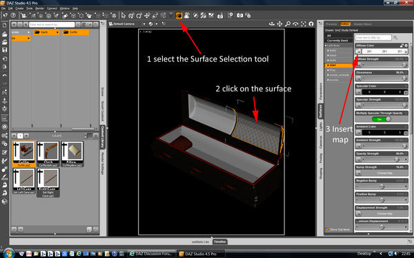

Here how to do one surface at a time

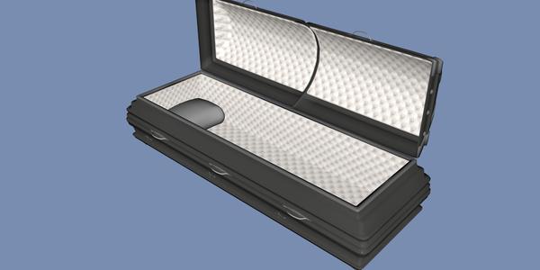

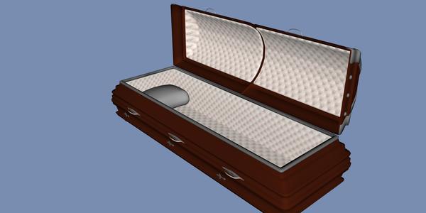

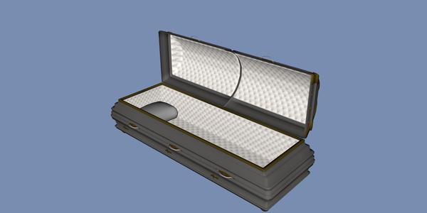

So far, so good. After considerable tinkering with the diffuse and specular colors, and applying the Surface Selection Tool as you showed me how to do (by the way, how do I get the icons to show up in the program window the way you have them lined up at the top of the window? REALLY basic question, I know :P ) the coffin now looks like this, much more realistic. I still can't seem to work out how to get the lining/upholstery texture, however (which you had in your own render).
EDIT: I forgot to change the color of the stands on the bottom. This has now been done, and once I can figure out how to get that lining/upholstery texture to show up, I think I've got myself a pretty decent model. (And I'm starting to tinker around with different colors, as you can see from the second image below.)

As for the lining just follow my instructions. Select the surface (inside left, inside right and the base) one at a time. Go to the diffuse channel, drop down arrow choose Browse > to the location of the texture maps. Select the pertaining maps for that section.

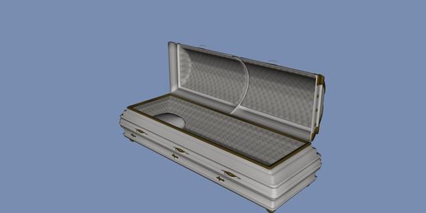

...et voila! :D I think I finally have it.

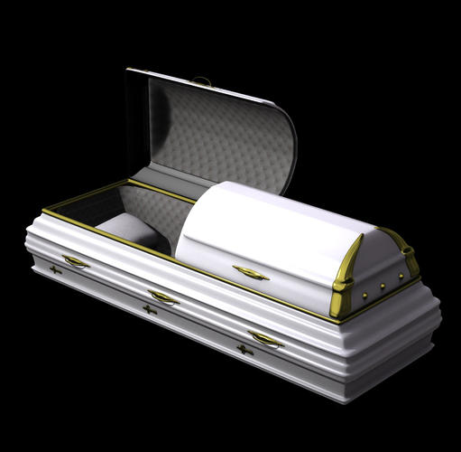

This is what can be done in ten minutes when you do this for long enough. :)
Oh yeah if you want to smooth out the mesh more just go to the Scene Pane select the coffin, at the top of the pane is a little square striped box click on that and you get a lod of functions....choose "Convert to SubD" or alternatively select the coffin, top menu bar choose Edit > Object > Geometry > Convert to SubD.
SubD is short for subdivision which subdivides the mesh make it fine a which hepls smooth out the mesh. But this doesn't work for all meshes.
In my render above I used SubD to smooth out the hard edges a bit more.

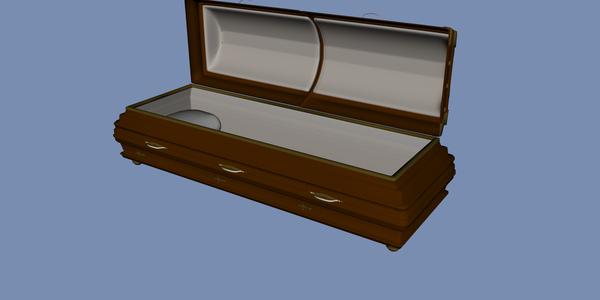

And this is the latest version. Aside from that I still haven't worked out how to get the handles the same color as the rest of the metal fittings, it's just about perfect now IMO. Now if I can just find the proper funeral-parlor furniture (bier/catalfaque, candlestands, flowers, etc.)...
