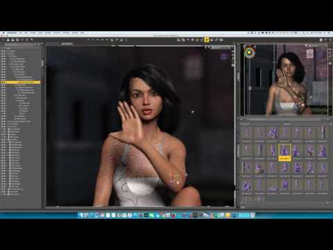

  • nickalamannickalaman Posts: 196
    I have found a way that works for me pretty good, jump to about 1:40 in the video where i manipulate a pose. I have iray turned on in aux viewport and smoth shaded in the main view port.

    Nickalaman, didn't know that could be done with the Aux Viewport! Cooooool this is even better!
    ~laugh~ do the dance
    janmclare, you got a 970sli wow better GPU spec than my 780-gen Titan. So your setup could definitely handle Manipulation Resolution at 1/2! Good to know it's working better. But yes now with Nickalaman's Aux viewport tip no more silly robot boxy limbs yay!!
    Off to play with new findings...
    Post edited by Mythmaker on
