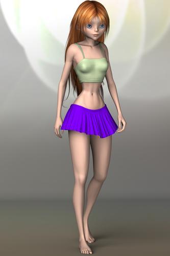

    Well, here's a quick Genesis dial spin based on Mavka body and Evolution morphs with a blend of A4/G4 head.
    Took longer to clothe, pose, and light the scene than spin up the character.

    Other than the thighs being a bit too wide, still, that's pretty darn close...and the thighs can probably be taken care of with a little more tweaking.
    I did a quick Blender sculpt last night and it took a while to get it right, and still wasn't as close. I'd either need to spend a bit more time sculpting or do the final tweaks with dial spinning, anyway.

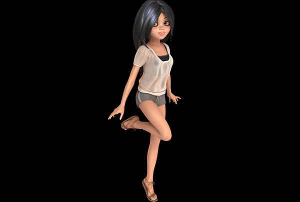

    I used alot of morph packs, especially some of Capsces brought over with Genx.
    The only problem would be that doing it using dials and not creating a new morph from scratch is that if you want to share it others will need all the same morphs.

    I agree it could use more tweaking but, like I said, this was a very quick spin up. The idea was to see how close I could get with a minimum of morph packs - and a minimum amount of time. :-)
    I suspect those body and head morph resource packs in the store could really pull this together but, like the dragon says, anyone you want to share with would need to own the same morph packs.
