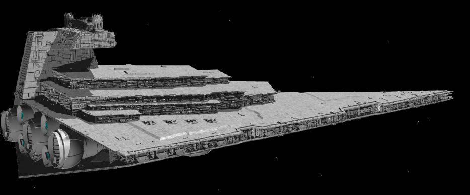

    Let's look at a model..
    http://www.matus1976.com/3d/sd/images/star_destroyer_5.jpg
    So, when planning out that Star Destroyer, what would your separate groups look like? Well, you'd likely have the main, triangular, shape as one group. Perhaps, it'd be best to have in a clamshell arrangement. There'd be the main body top, a separate group for the sides, the bottom and then a separate group for the back. All of these groups would have minimum details, all of them being gross structural details with no greebles/finicky bits. See the "raised plate" features on the main body? Not the superstructure, but those big armor-looking plates? Those would be separated from the main body. Why? Because - Adding those as part of the main structure would add more verts than needed, especially if you're going for all quads. Also, you'd have to put in extra edge loops for renderers like DS and Poser, since they don't do hard edges will without them, anyway. AND, if you're planning on soft-shading in your renderer, you'll be adding even more, since the renderer will likely make a hash of your hard edges without them if you did one contiguous group for just that main body, alone.
    Look at the superstructure. How many seperate object meshes would you use for the basic, blocky, shapes? I count five basic boxlike shapes. Can any be combined? Maybe two. Do I "absolutely need" to combine them? No. And, if I did, it'd just make for a heavier mesh that served no useful purpose for its extra weight. Since I can have objects intersect in both DS and Poser, if I were modeling it for those apps, they'd all be seperate box-like structures that intersected eachother, with the first level instersecting the body.
    What about the conning tower and bridge area? Two separate meshes, IMO. The engines/cowling? One model each of both engine types, then duped and moved as needed. I'd also make a seperate stern cap.
    Then, there's the details. First, we'd do a couple of different laser canon types and dupe/place those as needed. Then, the bridge details and shield generator. I'd also add some primitive hanger bays set up to receive a matte texture so they look like they had activity/ships/personnel in them or something.
    All in all, there'd likely be over twenty different "groups" of non-contiguous geometry and that's without the greebles and without counting duplicated geometry. (Greebles - Little fiddly bits of geometry that I can't reproduce with normal/bump/displacement maps that add nice surface details and keep the eye and imagination "active" as they roam over the surface of the model.)
    And that also means that UV'ing this model would be much, much, much easier. Some groups could be mapped solely using a primitive projection, without any touch-up. Some would probably need to be "unfolded" with some seams manually added to give the best UV map, though.
    A general way to go about considering how to judge how you should plan groups of geometry, off the top of my head:
    1) Will geometry be duped/cut/pasted? (Like with the two engine types and laser cannons)
    2) What parts of the model can be modeled in a symmetrical state, using mirroring to reduce workload and improve quality?
    3) What options present me with the cleanest possible topology?
    4) What options present me with the best ways to UV map the model? (Something you need to plan for in Hexagon, specifically, 'cause it can be finicky at times.)
    5) What "shapes" do I see? How many of them are "primitive-like" shapes and how many of them require asymmetry or details that are outside of the main "form" of the model. (ie: The main genre of "form" for the model would be either "Inorganic" or "Organic." Inorganic shapes, like hard edges, boxes, geometrical shapes vs Organic shapes, like a human elbow, face or an octopus a cat a cow a slime-mold, etc...)
    6) Which of the combinations of shapes are easily combined, like related geometric shapes with similar, close-by, geometric shapes, without much fuss? Which shapes can't easily be combined with others? (This is mostly an inorganic model. But, it has widely varying bits of details and differing types of generally primitive geometry. However, if I wanted to stick a squid's head on it, coming out of the conning tower, then I'd be combining not only general geometric families, but I'd be forced to create a lot of mesh density in very simple areas of the model, density that is absolutely not necessary if I only modeled the conning tower and squid head separetely, as individual meshes/groups.)
    7) Details - Which details require more density of geometry for their area on the model than the surrounding area of the detail requires? (ie: A cylinder shape that sits on top of a box. The cylinder requires lots of geomtry for a nice curved surface for the tube. The box only requires six faces or five, if one face can be removed and then that box intersected with another surface. Making those two, separate, meshes makes sense. Making that combined shape one contiguous surface doesn't make much sense from this particular perspective.)
    See the theme, there? Plan in order to make your mesh the simplest and less cluttered mesh possible for the model that you're building. Take certain considerations into account, like the demands of the application the model is being used in and what sort of texturing/mapping you need to do. Take into account presentation and versatility, as well. For intance, I planned for boxes to be modeled for the visible hangers and mapped so that a background "matte" could be used to simulate activity going on in the hanger, for low-resolution/long-distance renders. That's a few extra faces, but it's not very many and it increases the versatility/presentation of the overall model a great deal.
