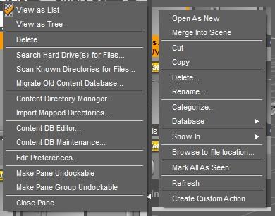

    strange. i got ds 4.5 but i cannot find anything there to convert into "poser companion file".
    390 x 307 - 52K

  • MedzinMedzin Posts: 337
    You won't see anything in installed plugins because it is not considered a plugin, but part of DS 4.5.1.6
    Make sure you have that version. I'm not sure if DSON checks the version of DS when you install it (since not required for minimum functionality)

    Are you using the latest build of DAZ Studio 4.5.1.6 found here: http://www.daz3d.com/forums/discussion/9471/
    You will also need the DAZ Studio 4 Pro version of software. Need to make sure you've purchased the Free version of DAZ Studio 4 Pro as it will put the Serial Number in your Available Serial Numbers in your account.
  • edited December 1969
    i guess my problem is: DAZStudio_4.5.0.114_Win64! it is not DAZ Studio 4.5.1.6 =)
    solved!
    thanks you!
