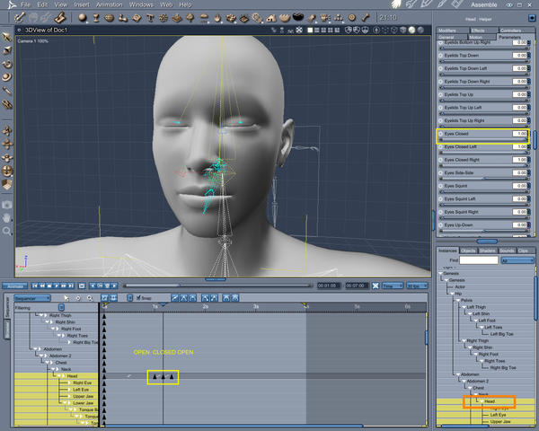

    You need to select the genesis "head" in the scene instance list, on the right. (see pic)... (click for big)
    you'll then see morph control slider in the Parameters section (top right)
    Scroll down that list or fiter the search box at the top for Eyes Closed.
    the eyes closed controls both eyes, but there are also sliders to adjust each eye individually.
    You would create some key-frames in the animation time-line, by moving the time-line indicator,.. then adjusting the eyes closed morph, to create a key..
    You need to create an "Open" key, then a "closed" key, Then another "Open" key.
    If you want to have a couple of Blinks,...
    You can drag a rectangle area around those key-frames to select them,. then hold ALT and drag those selected keys to create a copy and move them along the time-line to where you want them..
