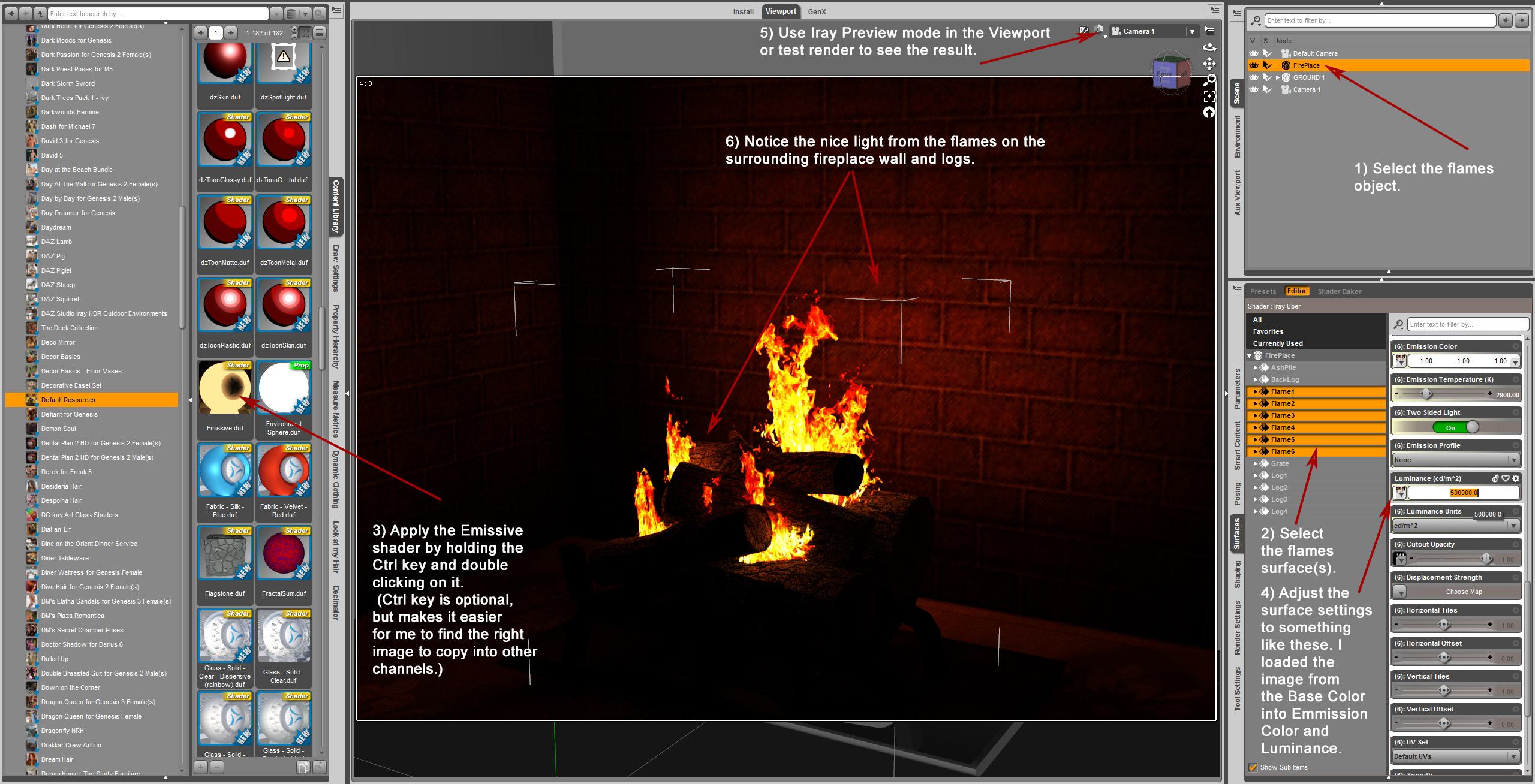

    Edit: Here's an important detail I left out! When you select your fireplace flames in the Surfaces pane, hold down the Control (Ctrl) key before double clicking on the Emissive shader. When the dialog pops up, Choose Selected and Ignore. That prevents the Emissive shader from removing your flames image from the surface. That is not absolutely necessary, but for me, it makes it easier to find the image I need to copy to the Emission and Luminance channels.
    Here is a step by step illustration. I used a fireplace log and flame prop from a freebie that is no longer available. You can use whatever flames you have. The flames in mine are just planes with a flame image and opacity map.

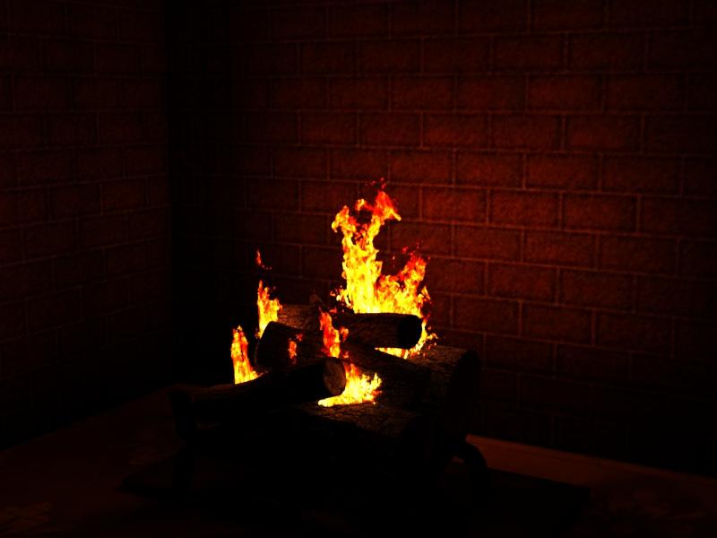

    Here is the render with only the fireplace flames providing illumination:

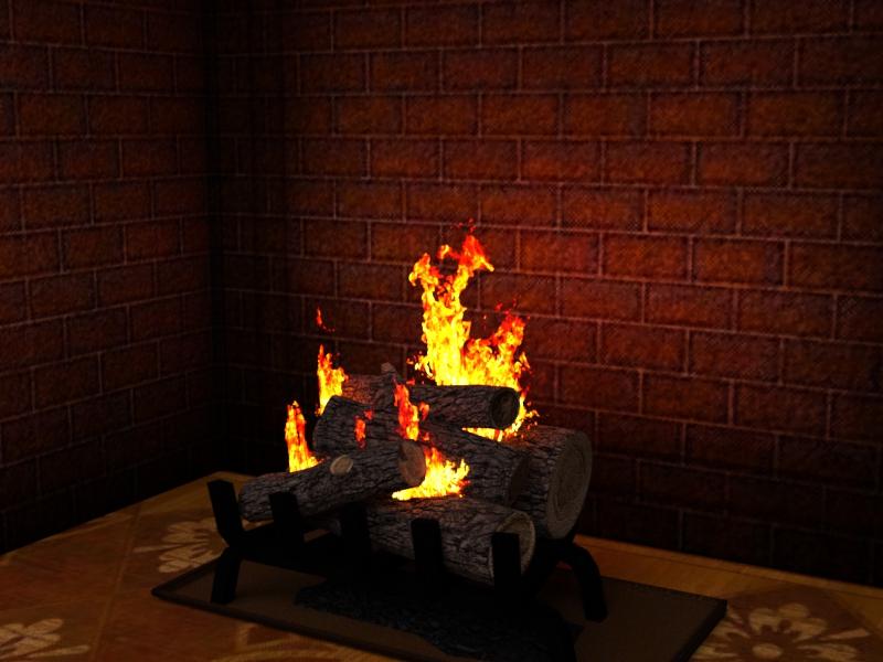

    Here is the render with some additional ambient room light:

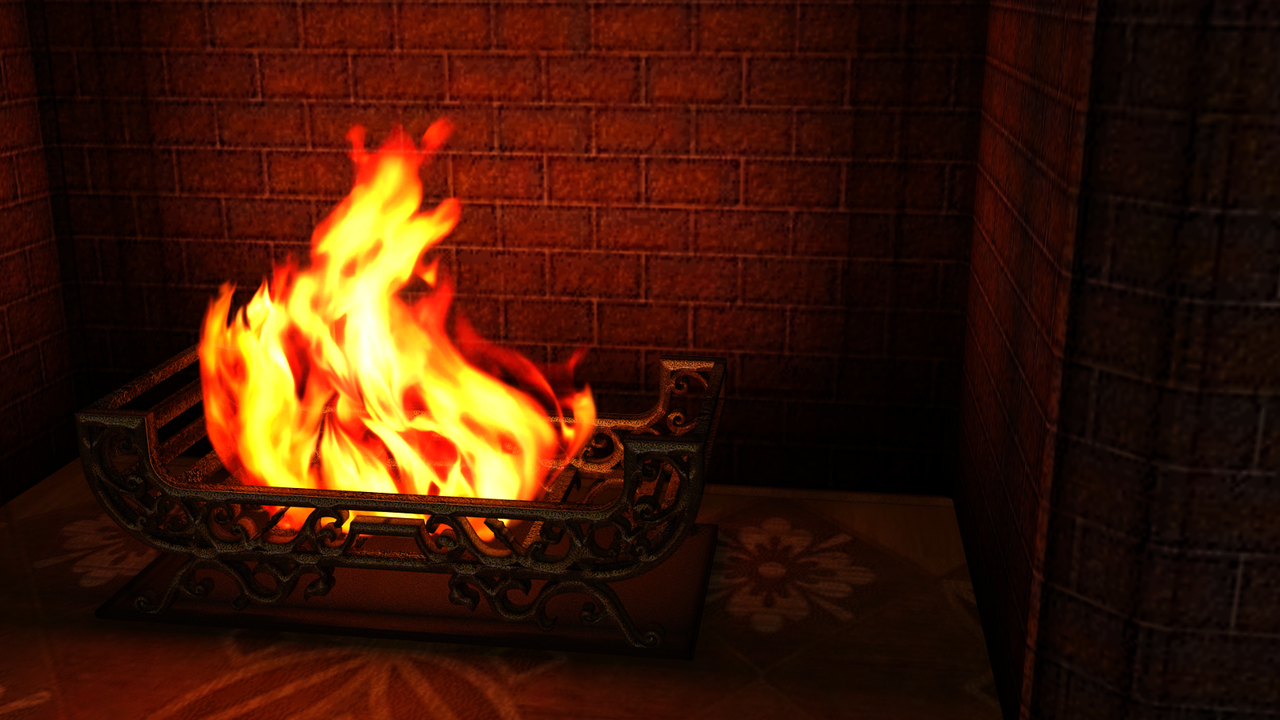

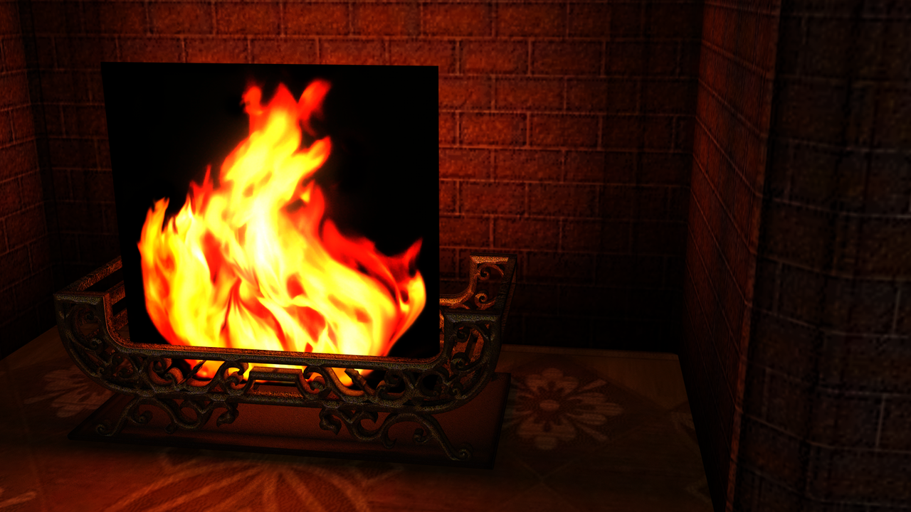

  • Recently switched from 3DL to Iray and am having trouble getting a moon sphere I made to work. It's just a sphere (made in blender, exported to fbx), added moon image to it from solarsystemscope. Making it emissive removes all visible detail (had to reapply the moon image after using emissive shader). Also made bump and normal maps for it. Have been playing around with various settings in surfaces, but no joy. When I made this in 3DL it worked perfectly and easily, any suggestions?
  • FishtalesFishtales Posts: 6,233
    Put the moon image in the Emissive shader under the Surface tab and adjust the Lumen until you can see it.
    Wonderful, thank you. And, in hindsight (of course), it makes perfect sense.
  • Son of the RavenSon of the Raven Posts: 119
    edited February 2021
    And should it reflect off of water with the right camera angle?
    I was able to get some light and light reflection by adding a distant light or a spot light. The distant light leaves a spot in the sky near the moon, even though it is positioned right on the center front face of the moon.
    3 pics: with distant light, with spot light, and a 3DL render from a few months ago of a beach scene (not to point of working on that scene in iray yet, so if you have suggestions for replicating shadow effects, feel free to share them).
    Edit: also a shot without adding a distant or spot light - there is some light and light reflection coming from the moon.
