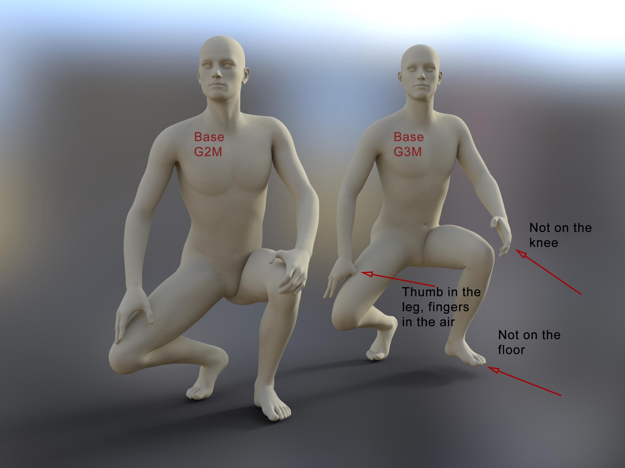

    I'd like to ask you whether you've been satisfied with the results of the pose converter. I've kind of given up on it, for anything but the simplest poses that don't matter if they are "off". Anything where the hands touch other parts of the body or another figure in a couples pose, never work correctly for me, even when I am careful to apply the Z Forearm Unlocker. I tried to convert the Center of Gravity poses. This is Crouch 03. G2M is on the left, posed with the original pose. G3M is on the right, posed with the Z Forearm Unlocker and the converted pose. I'm not good enough at pose tweaking to fix this without a lot of work. If you are getting better results than this, maybe I am doing something wrong.
    Because I'm not very happy with the converted pose results, and because I have to first apply Z forearm unlocker, I decided that I don't want converted poses mixed in with other poses in Smart Content. I prefer to have them just over in the Daz Studio Formats folder where I stored them so I know that those are converted poses that require Z Forearm Unlocker and might be iffy. So, I no longer assign metadata to converted poses.

    I'm VERY satisfied with this pose converter in particular. Yes, I've had hands go into the hip for "hands on hip" poses, but I kinda expect that as the body shape is very different to the original figure. I also have the Zevo pose converter, which is the one you apply the 'forearm unlocker' too, and I'm finding that this one, by  3duniverse seems to be a bit more 'correct'.

    Oh, I didn't click the link to see that you were using the other converter! I had forgotten about it. That is good to know, and good to know that you are happy with it. The converter I use allows you to specify where to put the converted pose files.

    Ah! :D I thought that, once you mentioned the 'forearm unlock' thingy. I always forgot to run the forearm unlock, could never remember to go and find it in scripts once I had applied the pose. This one, is super quick - I honestly actually sat there going "huh? did something go wrong" when it completed.
