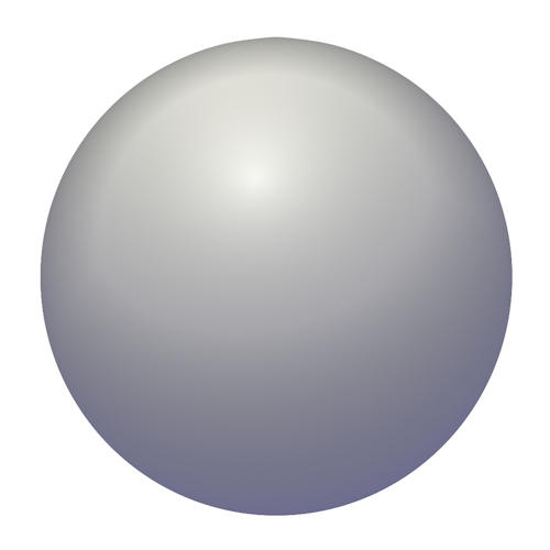

    Thank you ReDave. I did try the GI Macro and I got it to work. That was the last piece I needed and now I have the Mike King Gooch shader working! I am so proud of me. My plan is to use it for a tutorial for a beginner non-programmer person. Hopefully I can pass on my experiences of how I figured out how to use the Builder. I could not find anything at all that helped a newb understand the workings. I still don't understand everything but I will keep after it and continue to play with the Builder. I will create a new macro as you have suggested and see if it still works.
    Below is a Blue Grey preset I created with the shader.
    500 x 500 - 61K
    Wow...I like that one. I got a couple of other gooch shaders working, but none of them used the illuminance code.
    I guess I'll have to make an illuminance block, too.
