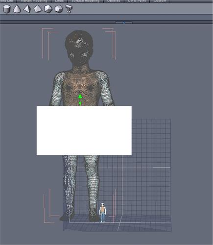

  • tdrdtdrd Posts: 0
    Roygee said:
    1. Use the basic Genesis, with smoothing set to basic. Export as .obj, using the default Daz Studio scale.
    2. import into Hex using a scale of 1. Weld all the parts into one and delete all materials - I keep a modified copy on hand for this.
    I tried the above - the resultant import was enormous... see attached.
    This can't be right. It's "honey I blew up the kid!"
    I've cut out an area just so as not to breach forum rules - there was nothing there anyways...
    1741 x 2000 - 527K
  • RoygeeRoygee Posts: 2,242
    Yes, that is the correct size for the import - doesn't look like a default, unmorphed Genesis, though?
    edited October 2012
    When you export the base res mesh for Genesis from DS4, save it as DS units, 1 unit = 1cm.
    When you import to Hex, make it Import Scale Factor 1.00, this will be quite large in Hex, but you don't want it too small because some of the tolls don't work properly with very small models.
    Export it from Hex at Scale Factor of 0.1 (Nought point One)
    Import to DS4 at 1000%, (One Thousand Percent), and it should be the right size.
    See if that works for you.

  • tdrdtdrd Posts: 0
    Thank you for that - excellent - I would never have sussed that out on my own.
    I eventually want to make these jeans/trousers into a freebee package for others on sharecg so how would I supply the users with different materials?
    I need to rig them first so i'm a bit premature with that one...
    Any good tuts on rigging out there?
    I've looked briefly at 3.am this morning but had to retire...
    Terry
